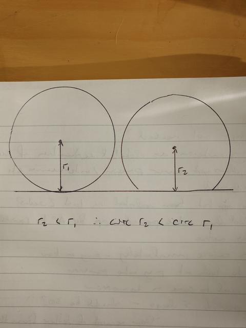

Discussion on UK Fatbike Club last night around whether lower pressures affect gear ratios.
My thinking was that a soft tyre would have a smaller effective radius (the effective bit being at the bottom where the tyre is flattened) reducing the circumference. In essence a smaller wheel size.
This was argued against as like a tank track- it doesn't matter on the shape, the perimeter will be the same.
I seem to have lost the argument but still can't picture why. Help!

If you reduced the pressure to atmospheric then the rim would be much closer to the ground. One revolution of the wheel would therefore result in less forward distance travelled.
Posted : 18/12/2019 11:07 am
Tank tracks are on solid wheels. You'll very slightly affect gearing ratios with a lower pressure tyre than a higher pressure tyre.
At the point the tyre touches the floor, it will be a smaller diameter.

Another way of thinking about it is that the key dimension is the diameter where the tyre first contacts the road surface (i.e. the forward most point on the contact patch). This will change only slightly if you reduce pressure.
The apparent paradox is because you are thinking that the circumference is determined by the vertical distance from the axle to the ground, when it is actually determined by the distance from the axle to the point where the tyre first contacts the ground.

Take an elastic band (or oring etc) mark a point on its surface and place it on your desk at a marked point, roll it along your desk whilst "circular" mark where it finishes 1 full revolution, repeat with the band flattened.
It'll finish in the same place.
The shape is irrelevant the only thing which matters is point a on the circumference is always the same distance (pi*d in a perfect circle) away from its self, no matter how you deform it, without adding or removing material that distance remains constant. If you made the wheel square each side would be pi*d/4, the travel would be the same but the axle would be a varying distance from the ground as it rotated.
#caveat being at high enough pressure the tyre may stretch, in practice I don't imagine that's by much mind.

The only difference changing the pressure has is changing the circumference slightly. More pressure means more tension and some extension of the material.
Ignoring that if the tyre doesn't slip clearly we travel the same distance per revolution. Some lovely explanations above about centres of rotation

actually..the elastic band idea helped me..
The actual CIRCUMFERENCE of the tyre is always the same - it doesn't stretch or shrink - it just flattens out...

The actual CIRCUMFERENCE of the tyre is always the same – it doesn’t stretch or shrink – it just flattens out…
That's how I see it and the radius doesn't tell you anything once the tyre is no longer a circle.

I disagree that the circumference remains the same. I think its slightly smaller with lower pressure.
I.E a firm tyre you could measure the circumference of the centre of the tread (the bit that is touching the road on a round profile tyre) and it would be, for example, 1000mm.
If you ran the tyre soft so the shoulder blocks of the tyre now touch the road, you, would measure the effective circumference around the shoulder of the tyre, which could be 975mm, no?

Circumference does not remain the same. There's a flat bit across the bottom of the tyre. If you were to run around in a big circle, then take a short cut straight across the last bit, you'd cover slightly less distance would you not? Same thing for a tyre with a flattened section. The lower the pressure, the longer the flat bit so the less the circumference. This matches up with the principle of smaller effective wheel size. If you were to do this experiment with a circular piece of string then yes flattening one part would make the rest of the circle larger. But a tyre is a 3D object - by flattening one part the extra material is bulging out sideways - this is how it's possible.
So the answer to the OP is yes, and there is no contradiction here.

Let's say you'd marked the circle you are running around with a long rope and joined the two ends. No you flatten the bottom of the circle and it's now a shorter distance which is what you are saying. So in which case what has happened to the bit of rope that represents the shortening

Perhaps the sketch above could be different; rather than having the bottom face as being flat where it contacts the ground, imagine it arcs upwards towards the hub so that the overall circumference remains the same. The real life tyre deformations make it look less like this up to a point, but if you think of how an underinflated car tyre wears on the outsides but not the centre it will be because the edges of the tyre are more in contact with the ground than the centre (as per the middle portion arcing upwards). Hence, the idea already mentioned about measuring as per the radius at the points it first & last contacts the ground would make sense.
Posted : 18/12/2019 10:04 pm
As I said - if you do the experiment with rope then you have this problem, because the rope is not compressible. But your tyre is. The extra material splays out sideways. If you get a flat tyre on your car, rim is obviously closer to the floor but the rest of the tyre stays the same size, it does not get bigger. The section on the floor just gets wider as well as flatter.
Posted : 18/12/2019 10:07 pm
Posts: 9763
Circumference does not remain the same. There’s a flat bit across the bottom of the tyre. If you were to run around in a big circle, then take a short cut straight across the last bit, you’d cover slightly less distance would you not? Same thing for a tyre with a flattened section.
That's an interacting point. I still think that the physical length of the tyre doesn't change. So if we now have a short cut where has the extra length gone?
On reflection I think that the radius goes up at the edge of the flat bit. So that's how the circumference stays the same. I was hoping to find ac sortable picture to test my theory
Oh another thought. At lower pressure the tyre gets less wide and taller, in cross section. So the radius increases ever where except the flat bit?
Posted : 18/12/2019 10:22 pm
the distance between the hub center and the ground is reduced
No, the distance from the hub center to the point where the tyre first comes into contact with the ground stays the same. With a perfectly round wheel, this will be the vertical distance from the ground to the axle. With a half flat tyre, this point is at the front of the contact patch, so considerably in front of the axle. The wheel is trying to pivot about that point, like a pole vaulter pivoting about the point where the pole contacts the ground.
