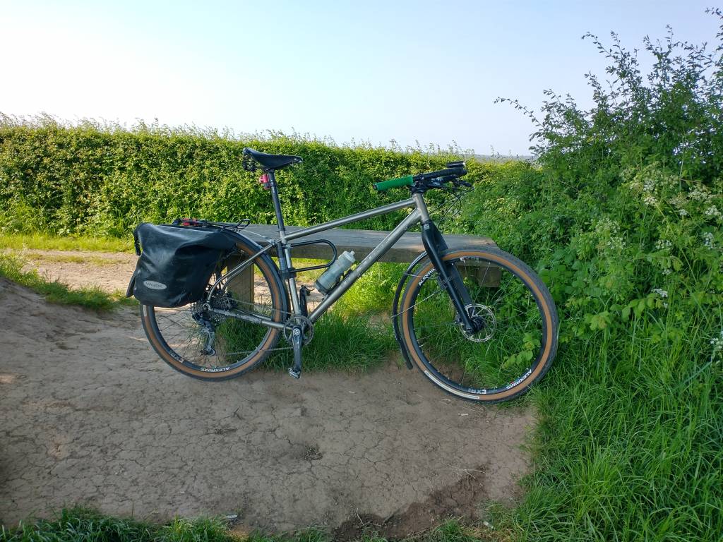

After finding a crack in my Titus Mutsu ti frame I’ve been considering what to replace it with*.
If you were looking for a bike/frame fitting the following criteria, which would you consider?
Steel
Rigid
29er/700c
Flat bars (not drops)
Boost spacing ideally (to fit existing wheelset)
Mounts for full length mudguards
Clearance for 700x50 plus mudguards 36-38t chainring clearance (1x setup)
I’ve got a 490mm a-c eXotic monocoque fork to reuse so geometry that’d accept that would be great, but not a deal breaker if it comes with its own decent fork.
Current frontrunner is a Kona Unit as the geometry/sizing ticks my boxes – I get on well with a decent reach (GeoMetron owner) so would be looking at XL sizing. A Surly KM is a good bit shorter reach with a 2deg slacker HT angle, and from what I’ve read elsewhere is a fair bit heavier. My worry is that something like a Surly KM or Kona Unit is too ‘adventure bikey’ and the frame might be overkill/overbuilt for my needs, i.e. might not be as comfy as a bike could be (I won’t be using it for carrying heavy loads – other than myself…). I’m probably wrong though?
The Mutsu was – I believe – a Planet X interpretation of the Sonder Broken Road (hence me now christening mine as a Titus Broken Mutsu) with near-identical geometry figures. It was nearly perfect for my needs so I’m looking for something close to that but steel.
What should I be considering?
Thanks.
* I’ve ruled out repair after doing some investigating – yes, its repairable but at a cost and wouldn’t likely be particularly pretty, plus who knows if it might crack again elsewhere in future.

Thanks, but none of those can take full length mudgaurds - that's essential for me. If I was looking for a replacement hardtail MTB then yes, but these don't work for this use.
Broken Mutsu

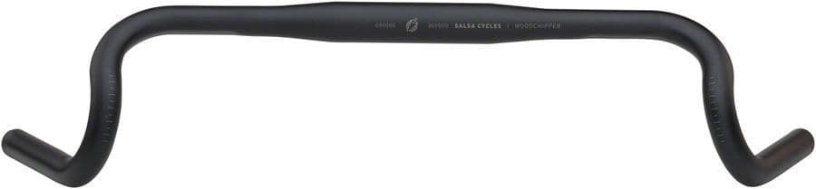

…I’m coming around to the idea of flared drops. I only ride MTBs so perhaps I’m just (irrationally?) scared of drops. Everything else about gravel bikes look ideally suited for my use so perhaps I need to give them another try. I need a proper test ride, ideally on my local trails.
Ritchey Beacon are brilliant. They have loads of outward flare but the drops are still parallel, which leaves your hands much wider in the drops than the hoods. They also have a very minimal drop, which is prob more important imo.
Posted : 13/06/2023 10:52 am
Posts: 624
Think there is still an XL Krampus at Backcountry in Aviemore. Details on their Facebook page
Posted : 13/06/2023 11:20 am
cjr61 and a11y reacted
 a11y
Posts: 3618
I'm new to understanding drop bar characteristics but those do look interesting. Minimal drop appeals to me as does width. I had a play on Cotic's configurator earlier and 52cm PNW Coast bars are an upgrade option, but these Ritcheys are even less drop.

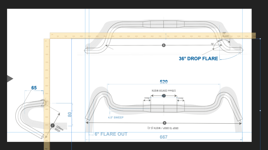

I ride Beacon XLs on my Cascade and think they're ace, but their Corralitos has even less less drop and I'd be tempted by them if buying now.
IMO, too many wide flared drops don't have a complete enough hook, which leads to a compromise between ramps and drop position. I like that Ritchey bars can have their drops AND ramps closer to horizontal than many others (of which I now have a shed full of rejects)
Posted : 13/06/2023 11:37 am
a11y reacted
Posts: 1679
@a11y the key thing is that flare comes in two flavours: either the drops' ends twisting outwards (like Salsa Woodchippers) or the whole drop rotating  outwards and upwards (like Ritchey Beacon)
People get obsessed with flare, but I think (minimising) drop is prob more important to be comfortable offroad
This site is great: www.whatbars.com
Posted : 13/06/2023 11:43 am
milan b., a11y and ped reacted
 ped
Posts: 144
Whatbars doesn't show side or top profile though, so you may have to do your own thing. For eg, here's my Ride Farr SupaWide vs Ritchey Beacon XLs with ramps rotated to a common angle.
handlebar profiles overlayed with each other
