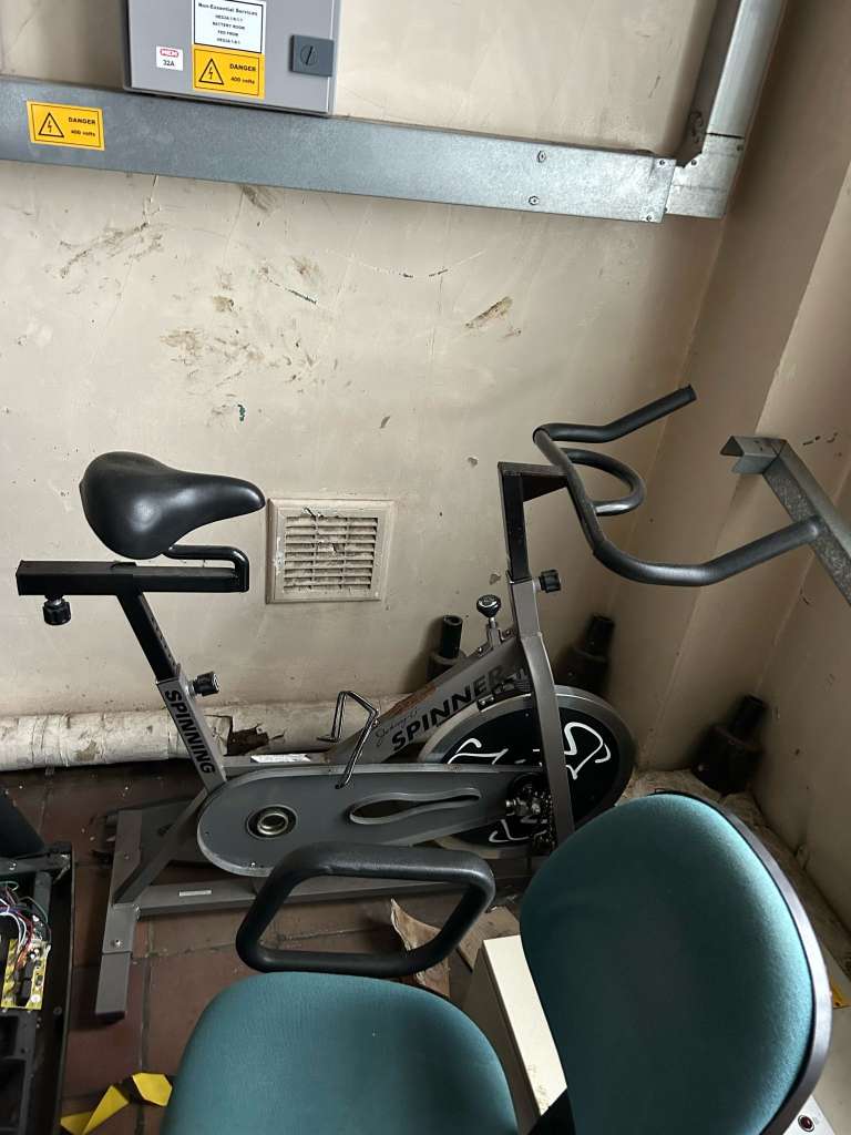

Thanks for the comments, we have two suitable frames and I'm probably placing too much emphasis on the faff of swapping them over. The only issue is I think mine has less gears and if they can't share a cassette I might need to buy some second hand drop shifters.
Someone has however found this at work this morning, if only I had the welder and skills to chop bits of this off and weld them to an old frame!
