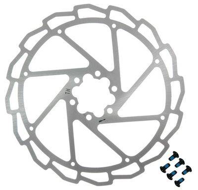

I went through a phase of using those alligator rotors (Aries, sawtooth and another one). They all lacked power, easily as much as one rotor size, maybe even two!
Some cutouts or drilling helps by letting water escape, and the gasses produced by burning resin, the pad does get gripped slightly by the edges, and the edges clean (abrade) the surface of the pad which stops ferrous material from the rotor contaminating the pad.
Once you've got some though, more doesn't seem to help all that much and the friction definitely decreases.

More edges to the braking surface actually give a higher friction coefficient don’t they? So highly drilled discs can be grabbier but if you go to far they lose their thermal performance and fade more easily.

Wont the solid disc heat up too much?
Much like car brakes - high performance ones are drilled and grooved for better performance?
Posted : 28/06/2019 9:05 am
Of course.
But rotors like Ashimas take it too far and lose the thermal performance. There comes a point where drilling the disk can’t overcome the loss of material for the heat to get dumped into, hence why a lot of lightweight rotors end up melting on long descents.
Posted : 28/06/2019 9:10 am
Fade at high temperatures is the resin in the pad compound burning off, the drilling and grooves in high performance disks give that gas so where to go. Without them the pad would float on the surface of the disk.
There's some good graphs on the brembo site showing the difference in braking g force with heat. The grooved and drilled disks are much of a muchness but do have more friction even from cold (and there's an argument that it will be even greater in the real world with water and as pads wear), but past a point the gap between the basic solid disk and the modified one widens considerably, that's what's meant by fade.
My experience of the ashima/alligator/Aries rotors was they ran hot all the time, even an xc ride would turn them blue. The power was a crap but never faded. The advantage of hot brakes was they remained bedded in all winter, managed months more of use without wearing out.
On balance, high friction pads and mostly solid rotors definitely offer the best braking performance.
I had a set of these rotors on my SS. I swapped out a set of Magura rotors with them thinking they would suit the minimal look of the bike.
Well the braking performance was also very minimal, shocking discs.
The dentist suggested I didn't use them again 🙂
Posted : 28/06/2019 9:56 am

Precisely. Like I was alluding to, rotor design is a trade off. Drill away too much material for venting and weight and you get a rotor that heats up to easily, modulates poorly and eats pads. Don’t vent it enough and the gases can’t escape and it doesn’t dump heat quickly enough into the environment.
There’s a reason why every major manufacturer has moved away from highly cut out wavey razer like discs back to good old round drilled discs, the former were shit.
Posted : 28/06/2019 12:46 pm
