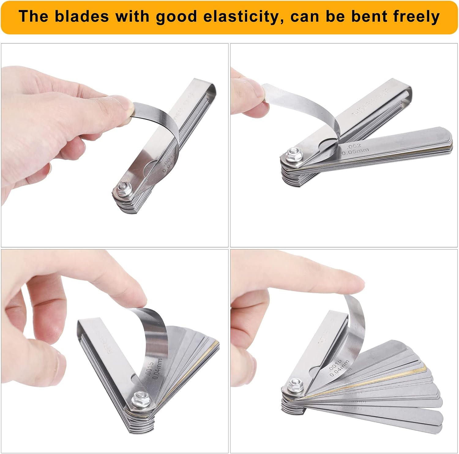

Prise the pads apart and loosen the caliper mounting bolts. Slip one blade from a feeler gauge on each side of the rotor. Clamp the brakes on and tighten the bolts.
https://www.amazon.co.uk/Imperial-Distance-Stainless-0-0015-0-035-0-04-0-88mm/dp/B0952XNT93

Seriously, if you think a brake rotor is capable of taking the torque reaction generated when tightening the calper bolts without twisting, you'll end up both wasting time and money, and still have a misaligned caliper. Take the time and walk the caliper into place one end at a time, and if your rotor and mounts are straight (sort them too if they aren't) you'll have a properly aligned caliper that doesn't flex the rotor when you pull the lever (if it does, then it's still not correctly aligned).

if you think a brake rotor is capable of taking the torque reaction generated when tightening the calper bolts without twisting, you’ll end up both wasting time and money,
It doesn't. You gently tighten each end of the caliper in turn just enough to get it seated, then you torque them up. No torque is applied to the rotor.
