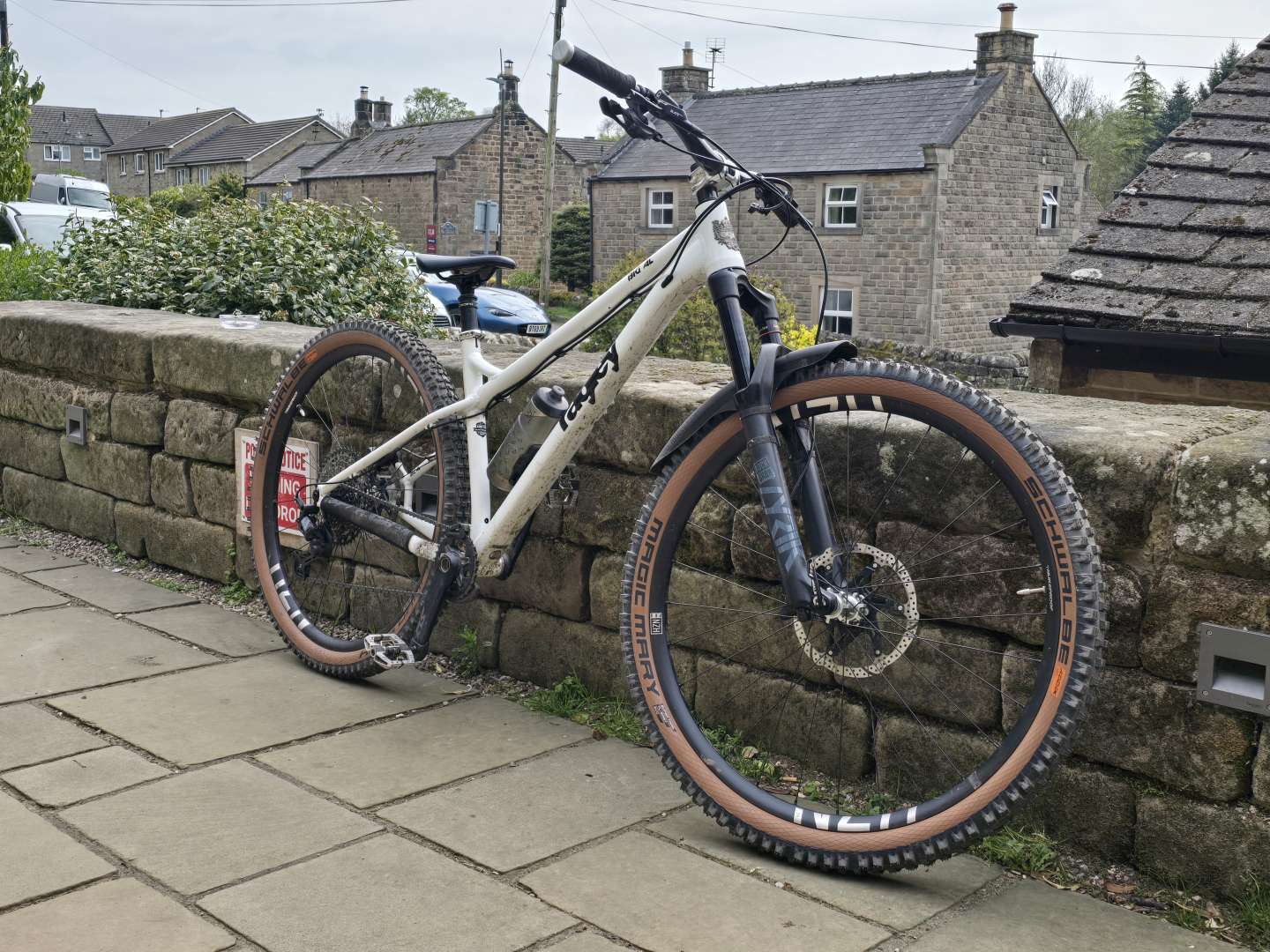

Posts: 3946
HT owner here, riding mostly in the Peak. I'd agreed with other posters that if you have too much travel at the front end the head angle increases too much as the fork compresses. Obviously on a FS the back compresses roughly in-line with the front.
I ride a Bird Zero 29er with 140mm Fox 36s and I love it. When I first got it a year ago I had a bit of a love hate relationship. Two biggest changes for me were the replacement of the Rockshox Revelation for the Fox fork which is way more capable and shorter 165mm cranks as the BB drop is quite aggressive so I was constantly hitting pedals on the old 175mm cranks. I didn't think 10mm would make much difference but it really has.
Edit: If you can stretch I'd be looking at grabbing one of those, great VFM. I was tempted myself, even though I don't need one.
https://www.stifmtb.com/collections/stif-squatch/products/stif-squatch-v1-1-am-kit

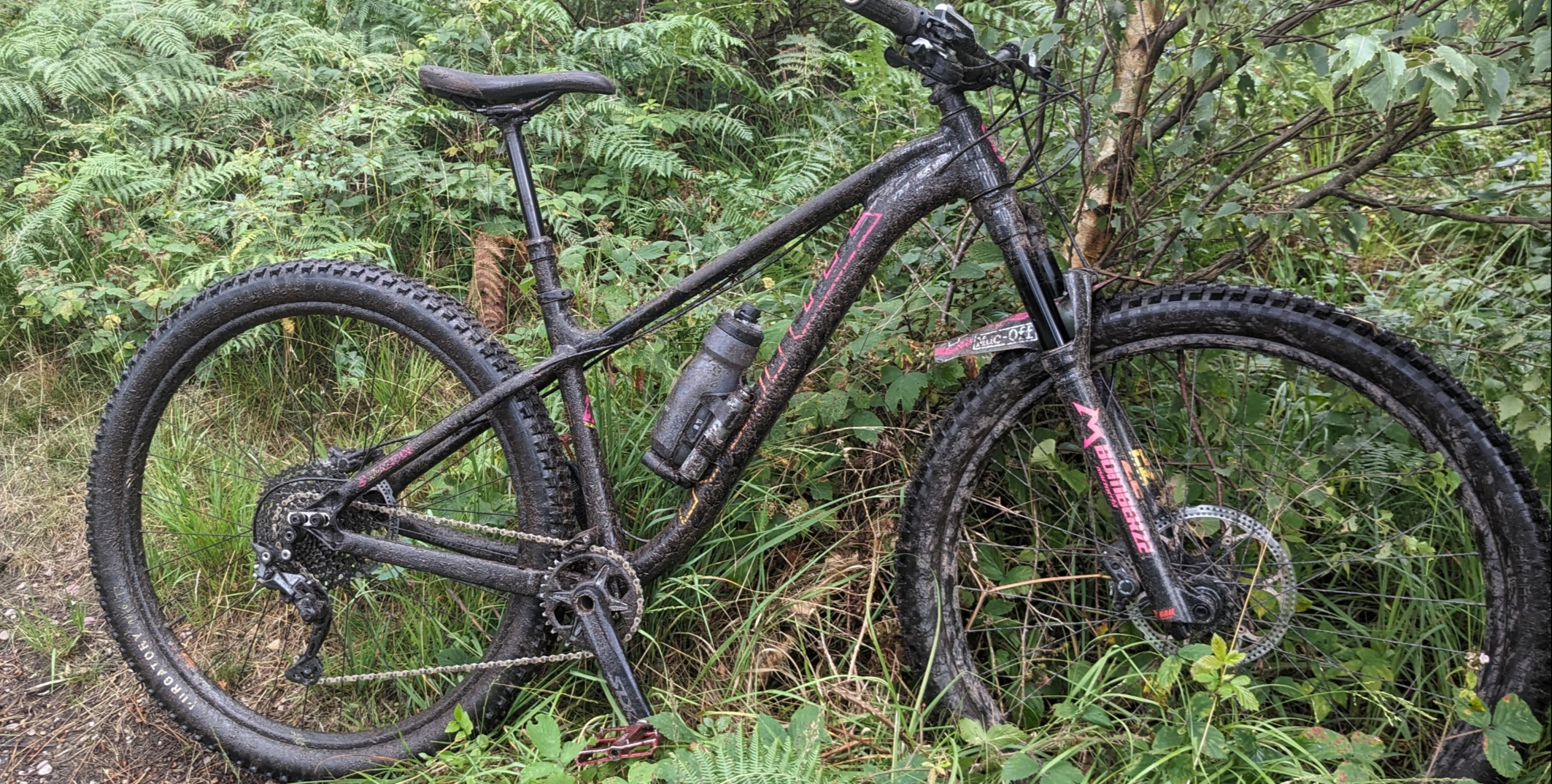

Posts: 33768
that Stiff looks like a proper bargain!
Ive got one of these and theyre on sale here £1200 with Revelations and full Deore
https://winstanleysbikes.co.uk/kona-honzo-dl-2022-bike?
Its pretty nuts how capable the bike is, I can ride much everything I can on my 160mm full sus, with the exception of big drops, I run chunky tyres which helps and a Z2 with a trutune insert
With a longish travel fork and long wheelbase, you get the stapler effect of hinging on the back axle and losing reach and getting pushed forward when you compress, so controlled damping / support really is needed, as chief said setup is different from a full sus.
I did look at something slacker like the Kona ESD but felt that would overlap too much with my other bike, if I was just going for 1 bike thought Id happily look at something slacker

I'd say Orange Crush fits the bill. I've got a 150mm Mattoc on mine which idms million miles away from the crappy Rev that it came with. 2.6 tyres either end made the biggest difference. It flies everywhere. Mine isn't at the cutting edge geometry wise with a 65 HA. I've often though about an angleset and whether it would improve things but I never really feel like I need it to be slacker.
I get the thinking about dynamic head angle changes with a long fork but in practice, I don't notice it. Damping on the Mattoc probably helps.
27.5 wheels also probably help because when needed, I can actually get my weight right back without a back wheel enema occurring.

When looking around for a beater hardtail frame a couple of years ago i bought a ragley big al in the chiggle sale. I wasn't expecting much from it due to my inner bike snobbery (853 Steel blah blah) but its turned out to be one of the best purchases ive ever made. So much so that the ragley + my orbea wild eeb have made my "do it all" trail bike (cotic jeht) pretty redundant and now going up for sale.
I've just stuck the latest 150 Lyrik Ultimates on it and its even better.
