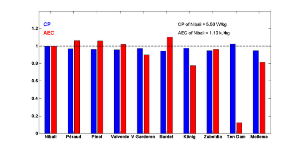

This chart sort of illustrates what TiRed is saying...
The jump from 4.3-4.5 is not coming at all.
The decline from 4.2 to sub 4 is coming all to easy here, winter weight and stupid colds 🙁

Posts: 6409
whats AEC in the graph above?
Posted : 11/12/2014 5:49 pm

dirtyrider - Member
Anaerobic Capacity, more or less your lactate threshold. 6w/kg isn't much use if you can't repeat it on the 2nd, 3rd, 4th climbs of the day. ten Dam would be winning grand tour stages if they consisted of a 50km climb and nowt else...

Posts: 6409
whys ten dams AEC so low then? its less than a fifth of the others in the graph, is there a story the pic is from?

Dirtyrider, don't know the source of the chart, but [url= http://www.fietsica.be/Grand_Tour_Champions.pdf ]this is a good read[/url].

Dirtyrider, it's from the same folks as Blobby's link above, but based on 2014 TdF
