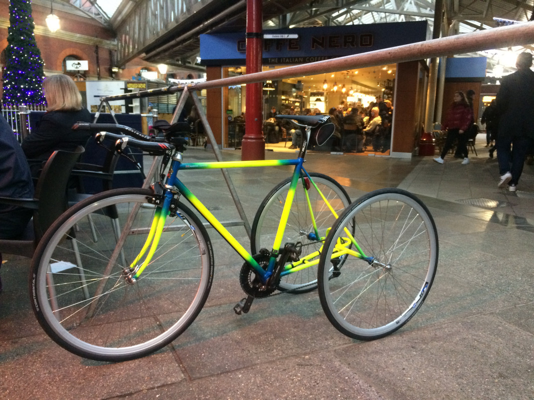

I have it on my trike and it looks fine. I have the long wire under the down tube. Seriously, just do it. Works fine looks fine.
Spot the cables. Note the battery is reverse mounted on the seat tube (obscured by a pedal). You can mount the battery on the Dow tube water bottle boss. Excess cable is wrapped around a chain stay bridge. The down tube has the di2 cable cover. I don’t run a FD so. A little easier but not much cable saving.
I have etap on the other TT bike. No real functional difference.
Tricycle
