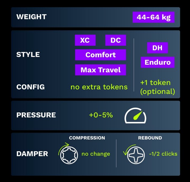

Hadn't thought of that - just had a quick look and they do one for the older 35mm Boxxer.
£100 is cheaper than the £400 damper upgrade....
Posted : 28/10/2025 1:44 pm
Posts: 40369
Absolutely, and it may have a more noticeable effect too.
You may have seen the threads on here where those of us who have them are raving about how good they are. I fitted one to a Charger 3 Zeb last year and it made a huge difference anyway, even at my average bloke 80kg weight.
Made me realise that most of my not-quite-happy feeling with that and my previous Charger 2.1 Zeb was with the air spring rather than the damping.
Posted : 28/10/2025 1:53 pm
