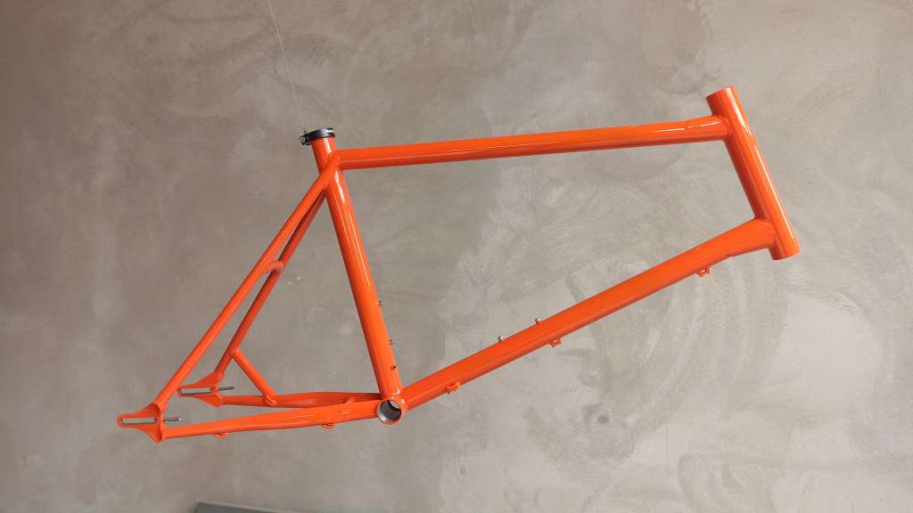

Anyway, here's part 1-
The geometry I've settled for is this, Long/ low/ slack:
18584 - Kai Hodson - MINIVELO

Posts: 2598
IMG_1274
My first update from Marino! It’s looking good. BB drop looks quite aggressive and the back end looks mega short. Should be fun!
I quite like how they have joined the SS to the ST. Pleasant surprise.
Im promised some more photos in the coming days and then I’ll do a little video update with the build spec.
Posted : 16/01/2025 10:00 pm

Posts: 2598
Now painted. Forks will be finished next week and then it’ll be posted. Not long to wait now!
IMG_1322
Posted : 22/01/2025 10:50 am

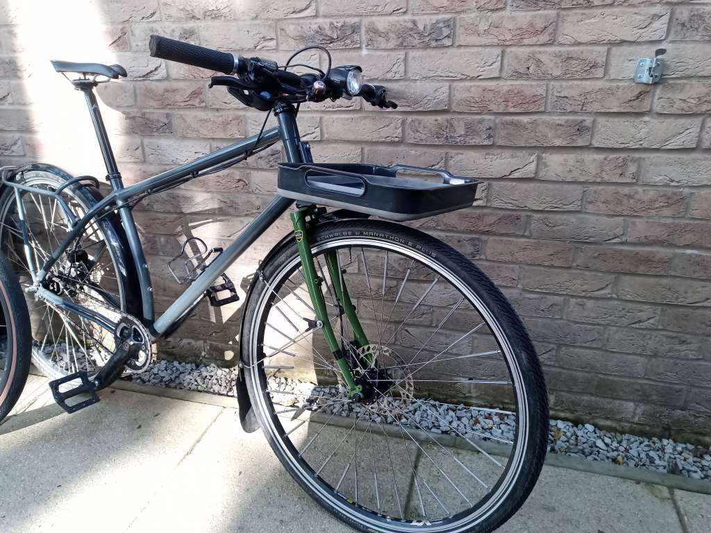

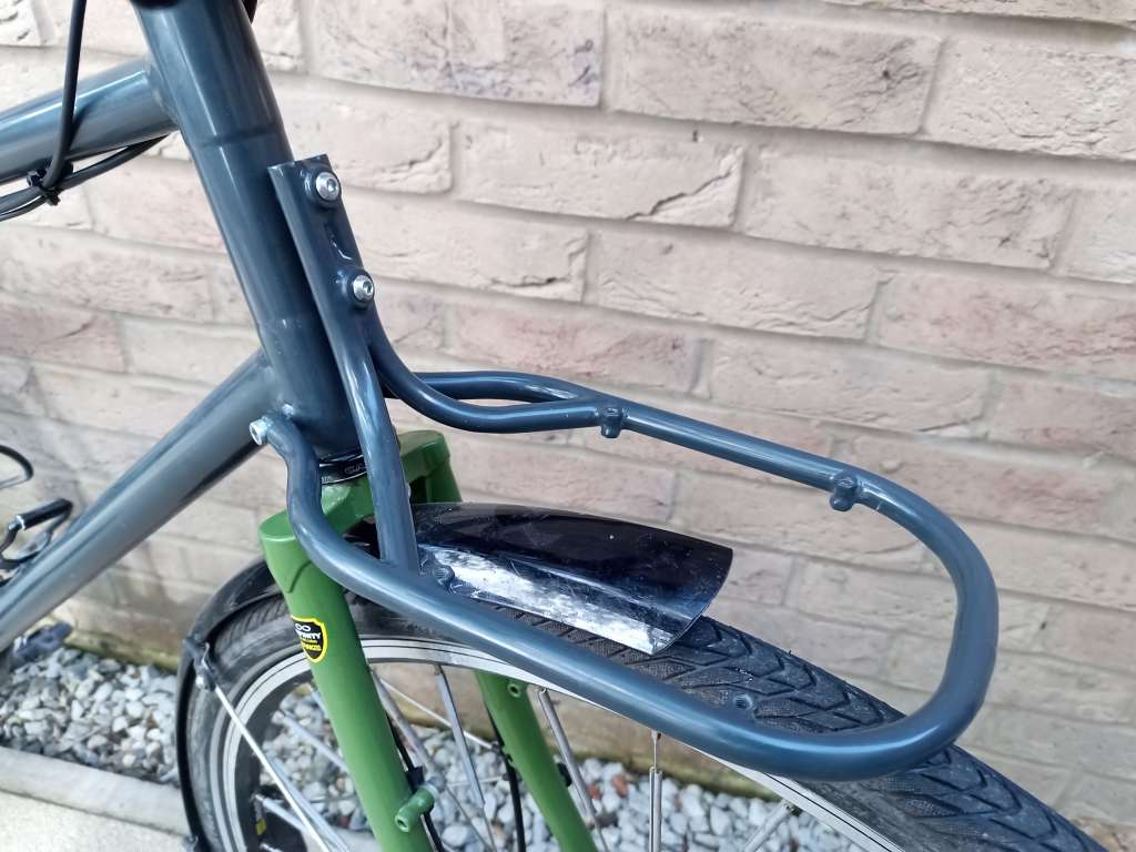

Posts: 3614
Excitement is building! Would be really interested to know what the steering is like (can never make up my mind what I'd use head angle / offset for a mini).
Interesting not to be using all that head tube for directly mounted rack. But saying that, you have probably made the right decision. I tried one on a 700c frame this year and should have used beefier top and down tubes - it all got scarily speed wobbly with a bit of payload and some rear panniers......
IMG_20240803_172928_208
IMG_20240622_170318_488
Nice to see epicyclo. I thought of you the other week when buying a Sturmey 3 speed with the rotary shift mechanism for a project ?
Posted : 23/01/2025 8:57 am

Posts: 2598
Nice bikes above ^^. I keep getting asked if this is a folding bike. I'm just trying to explain it's a normal bike with smaller wheels.
The fork rack is just a preferance. You're probably right that it might feel off, but not planning on any heavy transport.. maybe the odd keg.
