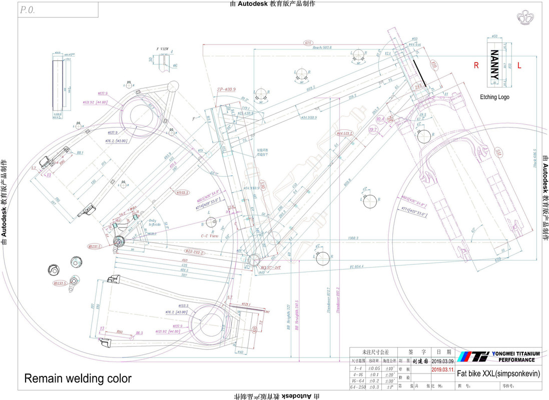

on the back of my 'why do I go through hope freehubs every 200km' thread, I had a brainfart.
XACD built me 'Nanny', my chi ti frame. Everything about it is fantastic, apart from the fact it flexes too much around the drivetrain, causing axle flex and buggeration to components.
So we have the blueprint already for a great bike that fits me perfectly, I do want to keep full fat/29+ compatability, what should I change on the design spec to lessen rear end flex around the axle?
(note, doprouts recently checked, they are aligned. Also, when I had this built we did talk about me being big so some tube thicknesses were increased already from standard)
Thoughts appreciated!

Maybe don’t use titanium and use 4130 butted tubing? Something like a Marino (yes I’ve bought one in the last 12 months) - he will make pretty much anything you want.
My frame for all round use has come in at 3.1kgs with rear axle and seat clamp fitted. I’d say that’s reassuringly strong! It seems comfortable (could be the 650b 2.6” tyres below g that) but I don’t feel any flex.
If you’re running such big plus tyres then any minor benefit from frame material flex is probably redundant and actually the last thing you want.

Interesting idea with Marino, had not thought about that. The only reason I went Chi Ti before was not the Ti, but purely as it was the cheapest way to try out geometry that I wanted.
Agree that frame 'give' for comfort is not needed given the bike only runs with big tires.
I guess the question is - what is it that will reduce flex? larger diameter chain stays + seat stays?
I have asked he famous Porter, will investigate with marino as well.

I also suggest steel. Also try sandwiched/composite BB/stays yoke. Much stiffer than simple plate.

Why dont you try bracing the seat and chain stays?
You'd probably only need to do the drive side but both sides would make it even stiffer.

I agree with @boxwithawindow. You love the frame, it is made of ti. Just get it strengthened.
Even with some plate added it will be cheaper, lighter and quicker than a new frame.
You might even be able to get a new rear triangle put on with thicker tubing.

Who would change his ti-frame though - isn’t it hard to cut / weld ti? I don’t think Enigma do amendments anymore do they - as they’re busy making their own frames.....
If you can find someone to weld it, perhaps some rear triangle bracing may solve the issue though 🤷‍♂️

I'd still try getting a solid steel bolted axle made first for the current bike.
I've done trussed stays in steel (12.7mm dia in my case). It gives you plenty of tube in lateral bending but the width of a single tube for tyre / chainring clearance without crimping or flexy plates.
[url= https://i.postimg.cc/8cYL3nhD/DSC-0631.jp g" target="_blank">https://i.postimg.cc/8cYL3nhD/DSC-0631.jp g"/> [/img][/url]
For you it could work with 17mm twin trussed chainstay tubes and maybe 22mm seatstays. Unfortunately quite labour intensive and I doubt anyone commercial would be interested in making one.
Or maybe an additional pair of stays between chainstays and seatstays? Would need careful design to avoid heel clipping and hitting the chain.

The frame spec you have doesn't look to be particularly built for stiffness, just some thicker-walled tubes for toughness.
A stiffer rear end may highlight front end flex and I'd expect a big or strong rider to be twisting that front triangle relatively easily. But yes larger OD stays would keep the rear triangle stiff if that's all you wanted. Go for diameter for stiffness and back it up with wall thickness at the ends for durability or in the centres to avoid denting too easily, or crumpling if extreme ODs and very thin-wall.
The Nicolai is a good shout. They look 'accurate'.. and like they'd need big tyres. You could also get a steel frame with a (maybe) a 38mm DT and 34.9mm TT, >19mm non-taper seat stays and tandem chainstays. It'd not be that light but no reason for it to feel dead or tank-like. Reynolds have some good butting profiles that would keep the weight down.

Hi Folks,
really interesting thoughts all, thank you. I think, in this scenario, you can really start to see the issues between a bike that I 'designed' with the angles and size I wanted, but with no real clue as to tube thicknesses and diameters other than that very generically offered by the builders (esp the Chi-Ti route which is very much 'we build what you tell us' with only marginal guidance offered, as well as help from other folks who have gone down this path)
It was a great & cheap way to find out what sizing/geo worked for me, but the constraints start to become apparent in lack of real design/engineering when it comes to materials. To choose butting, profiles etc increases costs of chi-ti rapidly, to the point where it does make more sense to just use a proper UK builder (really want to use Ben @ Kinetics) who really know what they are doing, and use steel.
Nikolai does look lovely, but only 177 rear end and would require custom geo that becomes eye waveringly expensive. So thats a no.
Salsa also lovely, but again, was looking for a 197mm rear axle.
Re. the solid thru-axle, I think, in my other thread, this was 'confirmed' as adding nothing to the stiffness of the actual hub-axle or hub - it only adds the benefit of clamping force and thus rigidity (which I have already tried with a bolt through axle at good Nm).
However, over and above all of this, my real realisation is whether I should continue to pursue the 29+/full fat angle. I never ride full fat anymore (well, very rarely on beaches and when there is tons of snow), and 29+ still has a lot of caveats of use by a big bloke. The rate of failures of components (mostly wheel related) on the 29+ set up is compounded by the scarcity and cost of replacements of fat/chubby components.

outside of a new frame, could you add reasonable stiffness by putting a (bigger) though axel in the dropouts? 12mm has some benefits over a qr

I'm not convinced about the axle theory (apart from the bit about an M12 through axle isn't tightened to anywhere near the correct torque to achieve maximum clamp load).
Your problem appears to be centred around deflection approx 1/3 down the axle in the poorly supported freehub and pawl area. A solid steel axle will be massively stiffer than your current hollow aluminium one. M10 end bolts screwing into each end of the new steel axle can also be tightened to somewhere near the correct torque. So you get a much stiffer axle and decent clamping load. This seems a very easy and relatively cheap option compared to a brand new custom frame. This advice may be wrong, but it is based on making a number of steel frames in the shed - many with "unique" chainstay arrangements 🙂 and 27 years in an automotive structural fatigue and durability lab (i.e. testing / breaking / improving stuff).
I agree on the fix but is going to make one for him?
That is a great question. @mick_r - you don't happen to have the capability (or know someone who might?)
Posted : 09/09/2021 9:26 pm
Posts: 3588
I could probably make a gash one using the shank of a big cap head bolt or some EN16 as raw material. Would prove a theory but pretty pointless as it will quickly go nasty and rusty.

Posted : 09/09/2021 11:29 pm
Posts: 3328
Don't have. scrap pile axle, Hope kept the last one.
However, I can easily bang an axle out of either of the rear hubs no problem, that would be amazing @mick_r , just let me know if he is interested. Amazing.
I had not thought of asking Ben, that would be option 2 I guess 🙂
Posted : 10/09/2021 9:59 am
Posts: 3588
He would be OK to do it - 304 stainless which isn't the toughest or most corrosion resistant but probably more than OK. £50 which covers him and the machine for an hour including material. They'd just finished a 3.5m shaft so this is pretty easy in comparison....
I'd knock you up a couple of aluminium top-hat inserts for the M10 bolts but would want to see some photos and dimensions of your dropouts just to make sure it would work. I don't mind knocking up a trial steel axle from an M20 bolt just to check it doesn't go crunch when you thrutch up a hill (it is basically a shaft with 17mm ends and 2 x M10 holes). PM me if you want to have a play. No problem if you don't.
Posted : 10/09/2021 3:04 pm
Posts: 3328
Wow, superb.
Messages on the way
Posted : 11/09/2021 8:58 am
