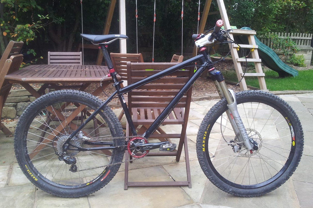

My first was a T-mars, 3 fixed positions. Up, down and nearly down. Look at that beauty!
