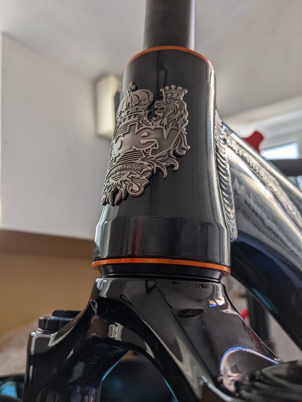

Brilliant - thanks so much for the instant responses. Looks like I've got the race and seal upside down!
Interestingly the race appears to have the rubber seal integrated, and it does look better the other way up. I've attached some more pics to show it flipped, then with bearing and in the frame. Looks ok to me, but do let me know if anything looks awry!

As per Mert, crown race looks upside down, the taper of the race should sit in the inside taper of the lower bearing. Yes you need to push the crown race all the way down otherwise you might think you've tightened your headset and then it will come loose in a ride as it settles under your weight. I put the slot of the race facing forward, I figure it's less likely to fill with mud from the front wheel but I don't think it really matters. I tend to cover all mating surfaces with a little grease, but not so much that it's oozing out past the seals where it will attract mud.
Edit: you've done it right now, top bearing sits in the top cup followed by the wedge and then the top cover

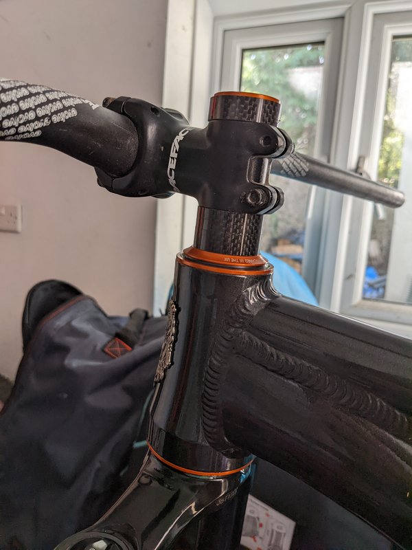

Steerer tube chopped, fangled nut bopped, headset, stem and spacers installed.
Job jobbed
The spacers look a bit rubbish, but it should be serviceable to start with and have a play with heights. Thanks again for help!
