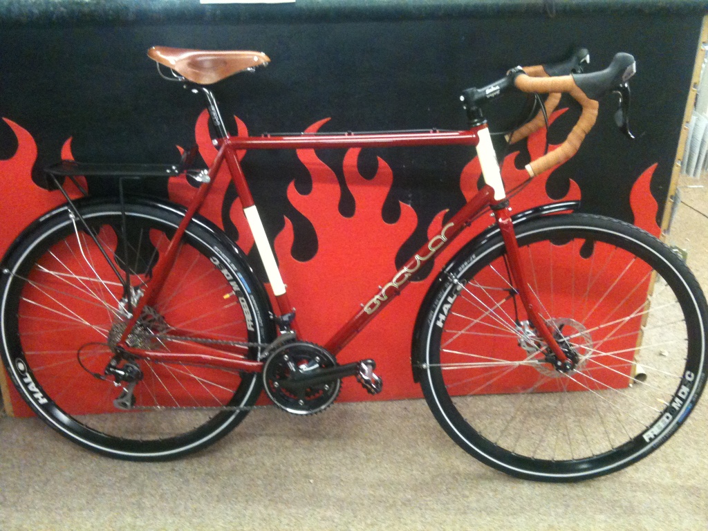

Have a look at the Singular Peregrine too. I've built a few lately for just what you suggest. Vaya's too, but the CdF is going to be the lowest cost option.
http://blog.sidewayscycles.co.uk/2011/10/13/just-like-buses/
As far as guards and sensible sized tyres go they wil all cope admirably.

The Pergrine in the picure above is a 59cm whopper. The more sensible sizes look better.
It's a great bike for fiddling with as you can hub gear it up easily too. Bags of clearance, but the front mudguard eyelets let it down a little in terms of disc caliper clearance.
