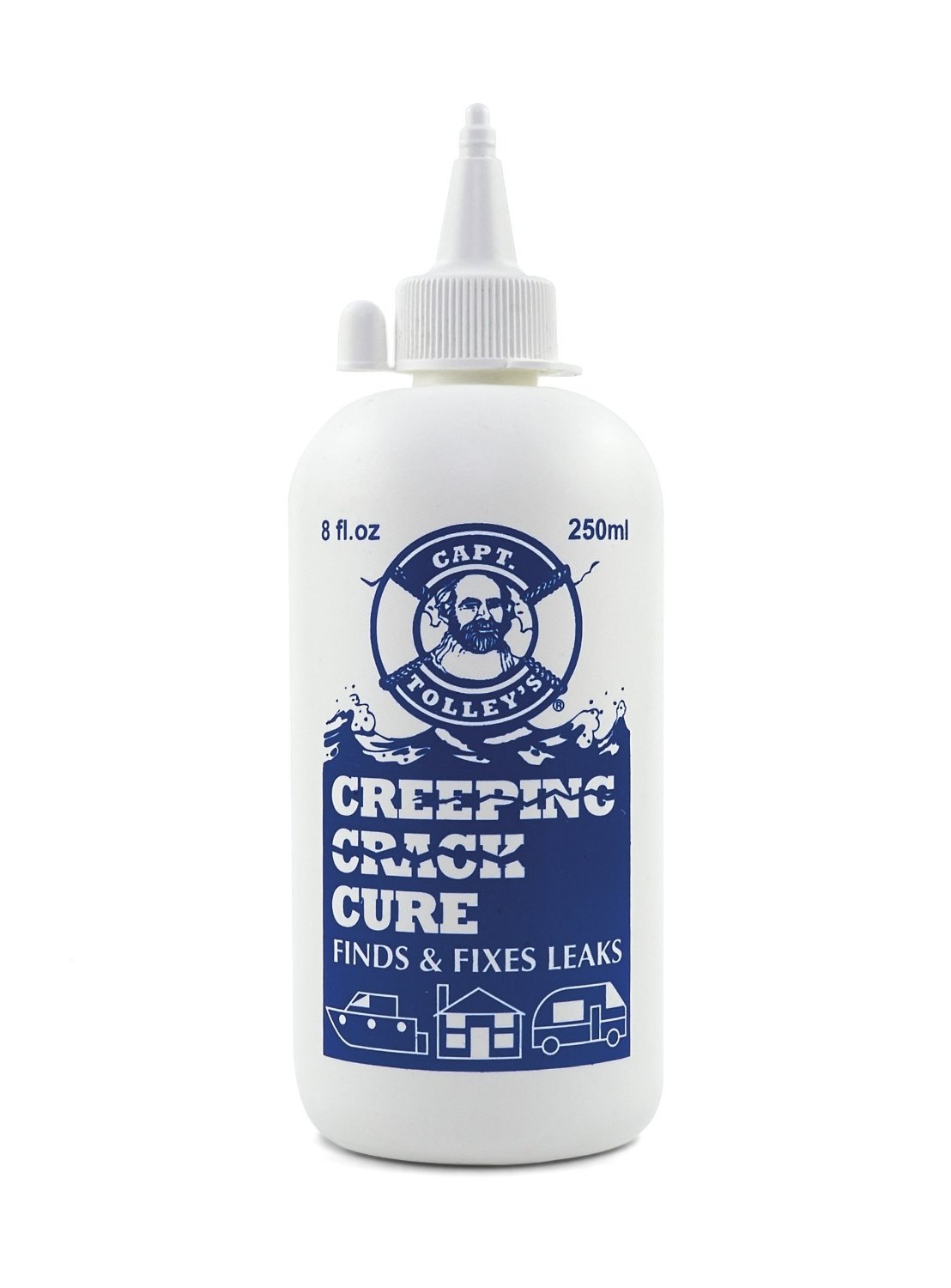

whats that super-seeking marine glue for hull leaks?
Aha, second attempt at google-fu successful
Posted : 13/10/2016 9:20 am
Assuming it doesn't managed to somehow run right through the assembly, that could be good stuff. I wonder if the strength of a bearing retainer might be better though?
