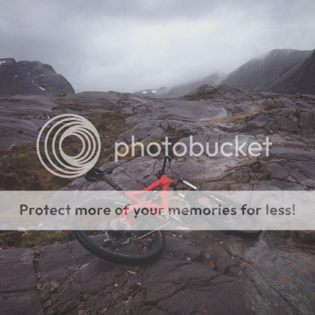

Anyway, I've been thoroughly enjoying my 2012 Orange Five as my only bike for the best part of 4 years, and to be honest would have been more than happy to continue smashing about on it for a good while to come, but unfortunately 'smashing' was the operative word and lo and behold it's got a whopping great crack in the swingarm.

Pic because why not right?

We want to see the crack...!

Show us your crack! S****

Haha. I've not been able to get a decent pic of muh crack. It's a 4 legged beauty though and ever expanding.
I guess the consensus is still that welding an alu frame isn't going to work? Don't think I've ever seen it done successfully...

For the price of a head tube adapter (top race as your five is tapered) you could be up and running in very little time. The only fly in that ointment may be the swingarm on the new frame which will almost certainly be maxle, whereas on your 2012 frame it was an option, which from your pic it appears you didn't select.

Out of interest OP, did it go just behind the shock mount? Any piccies?
Posted : 06/07/2016 9:37 am
The crack is around the little drain hole in the middle of the swingarm underside, extending along the welds either side. I suppose there's quite a bit of torsional load going through there, especially as it's a QR back end and I tend to fairly heft it around.
Managed to get hold of a Maxle swingarm off eBay, so hopefully that fits and I can go back to making incremental upgrades and get another few years of use out of the old sled.
