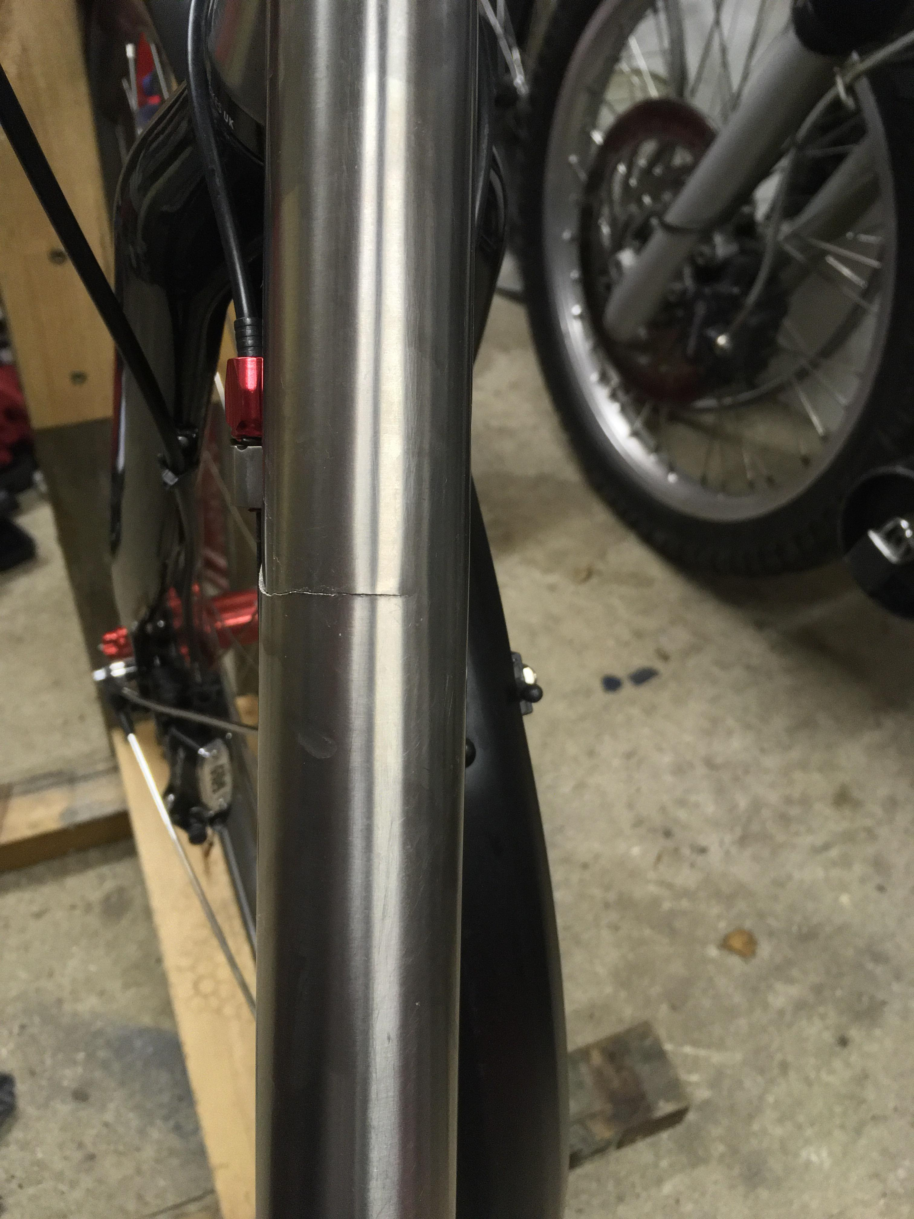

I've had my Mk 1 Tripster for about 4 years now, bought second hand off the classifieds, and it has been fantastic.
Made the mistake of cleaning it today and discovered a crack in the weld on the drive-side dropout.
dropout crack
cracked dropout
So, i presume its repairable, but at what cost?
I've sent an email to Enigma to ask for a quote. Where else should I try ? (West London ideally)
Kinesis offered 25% off a new frame, but I cant afford that unfortunately. The AT is a possible alternative though.

Update - I sent to Limit Fabrications as recommended by TiBoy up-thread. He fixed it very quickly for £100 and it's on its way back to me now.
I started to build up my old Crosscheck in the meantime, and the difference in weight (with a steel fork too) is stark at first. Never got far enough with the build to compare the ride quality though.
The skinny crosscheck does look cool with 47mm tyres, so thinking about sending it away to get a disc mount welded on.
Posted : 21/09/2020 10:49 am
How was the work from Limit Fabrications?
I am looking to send my Tripster ATR V1 frame there for repair after it cracked nearly all the way around the down tube at the cable lugs.
They and Kinesis are recomending that the whole down tube be replaced!

Rich from Enigma here. In the past we have offered repairs to other titanium frames, but we've been so busy this year it's something we've had to put on hold for the time being.
Sometimes we have been able to simply weld over a crack, but other times due to the chance of it going again it makes more sense to replace the whole tube. If the tube is cracked around a significant proportion of its circumference then it certainly makes more sense to do this.
Stays tend to be difficult as us having a single matching stay (diameter, taper, bend etc) in stock is unlikely, so we have sometimes recommended a pair of stays or the whole back end is replaced, but of course this is rarely economical to do.
Anyone is welcome to email us pictures of their damaged frame for advice or a quote, but at the moment we're unable to commit to completing repairs in a reasonable time frame.

What would people say a Tripster Atr v1 frame is worth?
I’ve had a rough quote of £400 to replace the tube plus postage back and forth.

I would sell your cracked frame on eBay & let someone else take it on.
Only because so many in this thread have cracked and yours may crack again somewhere else after repair.

Pat Banks @ Limit as above would be my recommendation - he is on the outskirts of Norwich and builds (not just repairs) Ti.
Vernon Barker often comes up as an option but as above can be a little agricultural.

Hello. OP here.
Thought I'd drop in a picture of the repair:
repaired frame
Pat at Limit did a great job and got the frame back to me very quickly. I have since done some fairly demanding rides around the surrey hills and SDW and all seems well.

That is very neat indeed, and since it is under the chain stay, won't even be noticeable.
Glad it all worked out. Nice job.

that repair is a spot on IMHO
