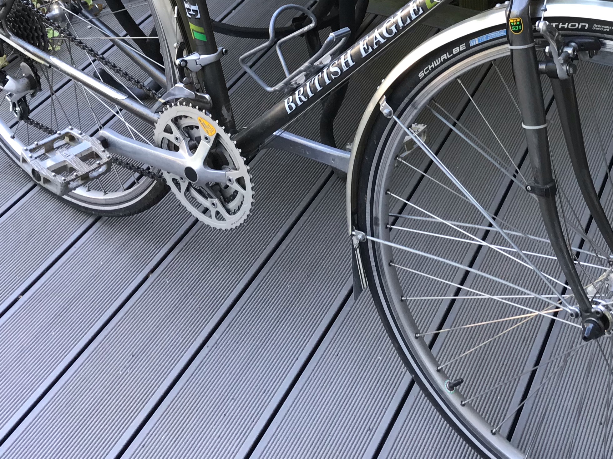

Posts: 3642
Agree with dovebiker, ie it’s probably a ‘suck it and see’ thing.
It was common for early 90s road-touring bikes to have MTB triples. Mine has a Shimano Biopace. Works like a dream.
*edit Ignore the pedals. I have peculiar requirements 🚵🏼‍♂️.
Posted : 03/10/2020 9:40 am
