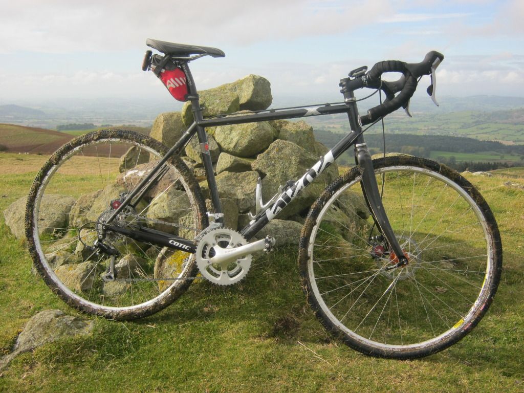

http://s162.photobucket.com/albums/t261/speshpaul/Cotic%20X/
I'm using a xt 34 cassette and tiagra Compact. I'm not racing, just messing about.
Posted : 11/03/2013 9:46 pm
Speshpaul - is that an xt rear mech?
Posted : 12/03/2013 8:36 am
Posts: 3378
No it wasn't but it is now, 9 speed XT to work with 10 speed Sti's.
