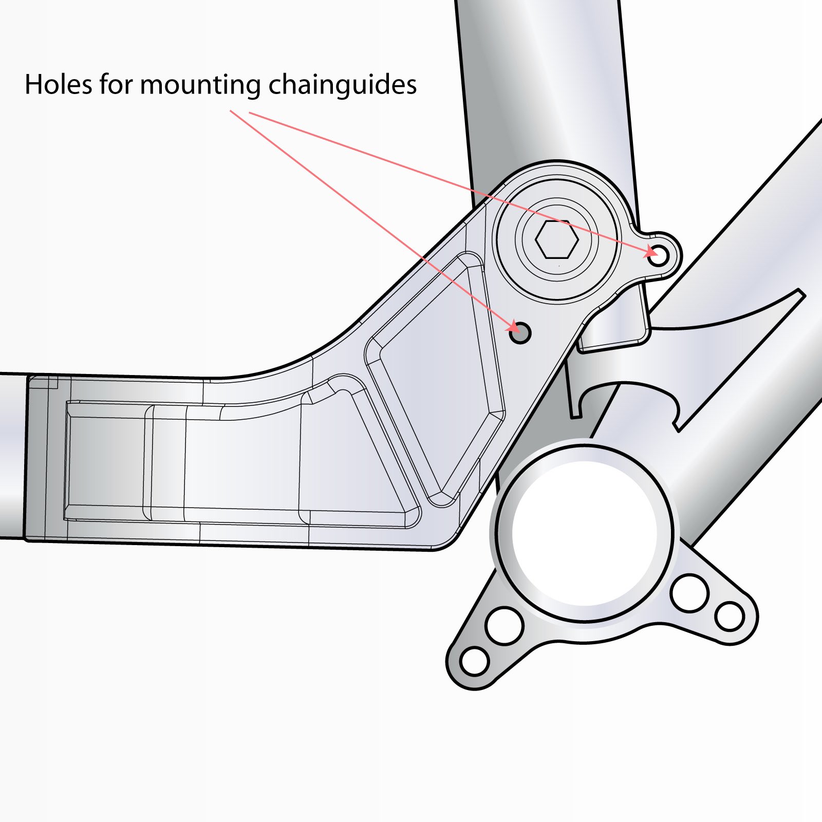

Should probably just email cotic however.... Can any one tell me how the integrated one up chain guide fits onto the new Cotic full suspension frames. The pictures look like it mounts into the lower suspension pivot (i.e. the pivot bolt is threaded). Is that correct? Trying to work out if I can retrofit to an earlier Rocket.

Do you mean with the older swingarm without the mounting holes? I'm afraid not. Hold on... I have a diagram open in front of me that shows the mounting holes...

Mine is caked in mud but it looks like the swingarm has a thread in it so you won't be able to retrofit it.
The guide is the top part of a https://www.oneupcomponents.com/products/top-guide, without the special thread you can just use a normal top guide and mount onto the ISCG.

Holes

Thank you 👍. Couldn't see those extra holes in the photos.
Yeap can just use a iscg05 mounted version. I already have a taco using the lower 2 holes so was wondering if there was another way of mounting a top guide without replacing the taco.
