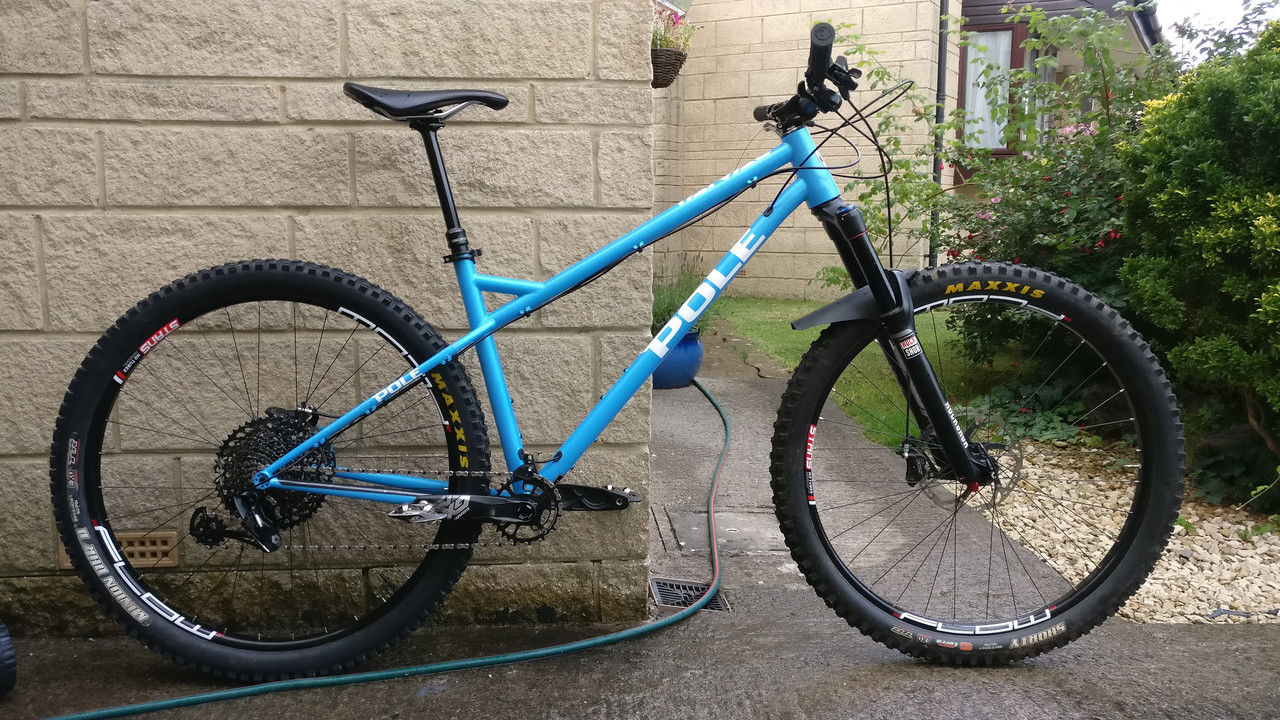

How is your Taival set up?
Thus:
null
Posted : 15/08/2019 1:03 pm
Very tidy that!
Notice stem is slammed. How tall are you and what size is it? Wondering if head tube will be too tall for me.
Posted : 15/08/2019 1:11 pm
Posts: 7898
I'm 182cm. Its a medium and Pole say I should be on a large, although I'm right on the Medium/Large split. If I was ragging on open moors all the time, I would have got the large, but I do lots of tight woodsy singletrack so went for the size down. Even so, its wheel base is 1258mm, but it just doesn't feel like its that long.
The stack is high. What I've noticed about these longer front centre bikes is because your weight is more forward due to steeper seat angles, the bars don't need so much downward load to pin the wheel for grip so you can run them higher for better control and more resistance to forward ejection. Its another aspect of new skool LLS that is markedly different from traditional thinking.
The flip side of this is that if you have a long reach but slack(er) seat angle, there is a sort of gap between your seated and attack position, where you need to consciously move oneself forwards, which can provide a delay to handling where you don't want one.
