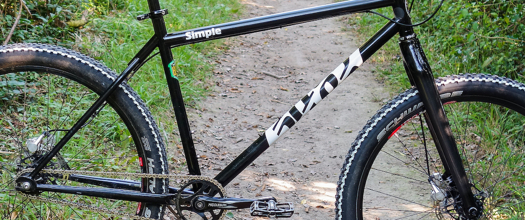

I've been building up a 26" Simple over the last several months for a great friend of mine, currently it's got a 32t Middleburn ring up front and just needs a rear sprocket now. I'm trying to avoid chain tugs and also noticed some guys can run their Simples without any tensioners:
Does anyone know which rear sprocket sizes would allow for the axle to butt up against the dropout with a taught chain? Or at least close. The options are- 32:16, 32:15, 32:14.
If anyone knows and would be willing to share, that would be amazing!
Thanks

Slightly off topic, but the bike in the picture at the top has a set screw/tensioner of sorts drilled and tapped into the dropout between chain and seat stays. 8O. Had a quick google and it doesn't seem standard, but I also found another one with a less pretty version of the same thing. I would imagine this mod/bodge is harder to do with smaller frames/tighter rear triangles.
Also whatever chain tug or magic ratio you find does not cure How bikes with slot drops with seatstay brake mounts want to spit the wheel out backwards under heavy brake loads - you might still have the chain properly tensioned, but the wheel pointing to the left at the bottom of the hill (why the slotty inbred has the mount on the chainstay instead -there used to be a much better explanation for this than mine on the o-o website). So whatever you do with chaintugs, a really good grip on the nds dropout is needed for this bike too - bolt up hope hub with nice new sharp grip washers is ideal.
Posted : 05/05/2015 6:41 am
Posts: 1781
Appears to be standard on Simples? From Cotic website:
The frame I've got has it. Not seen before & seems like a good idea - although agree on the need for it to be bolt-up!
Posted : 05/05/2015 7:19 am
