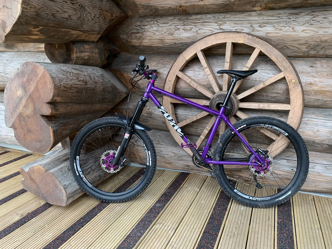

Posts: 1383
Here’s mine, purple medium 26”. Pikes - tapered IIRC, DT Swiss wheels, usual Shimano suspects for drivetrain.
Brilliant bike, I’d accumulated all the parts over a long time for a variety of builds that never quite happened, so this has some quality stuff on it.
Given it’s not the most modern of geomotry now, it rides a bit like a bmx (to me), which is no bad thing, feels lively and can handle bigger hits and stuff than the rider can.
Mine is currently dismantled, reminds me I should put it back together for when I can ride again.
