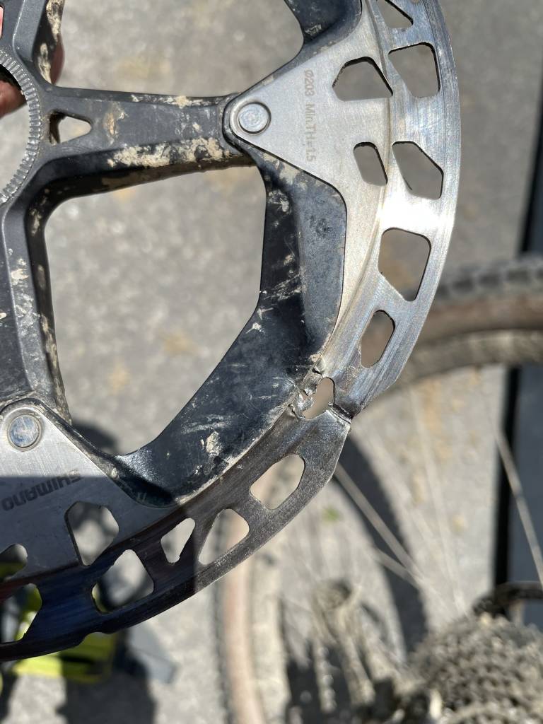

Posts: 4132
Do also check your rotor thickness prior to leaving. This happened to one of our group 500m into a 1500m descent. 😳
Posted : 12/07/2023 11:35 am

200mm rotors (at least, unless you’re teeny)
Just back from a week in Morzine. 180 rotors both ends were perfectly fine for me, and I'm 100kg (plus gear). Might not be the raddest of the alps, but still quite a bit of vertical, and momentum to turn in to heat before Newton made me go light speed.
Shimano are just too inconsistent
Mine (M8000) were again bang on consistent all week, with the only exception being the ride to the first lift after the bike had been stored vertical overnight.
Stock Shimano resin pads too. That set has done a week in Torridon and Aviemore, and another week in Glentress/Inners, at least. Did need to change them on the 5th morning.
Did consider 3rd party pads, but last time I used them I got stung. Superstar ones were coming off in chunks. And in our group last week, most of the rest were on EBC / Uberbike and somethign else, and were the ones with blued rotors, even though it's me that's more at the brake dragging end of the spectrum.
Hoarded a decent stash of Shimano resin pads, so I think I'm sorted for a while yet.
edit: oof! at that rotor though

Just don’t run your pads to the metal too often please
Posted : 12/07/2023 9:47 pm
RustyNissanPrairie, footflaps, thols2 and 2 people reacted
Posts: 40369
Woah :O
At least the other bit will make a cool ninja throwing star.
Posted : 13/07/2023 8:47 am
Del and footflaps reacted
