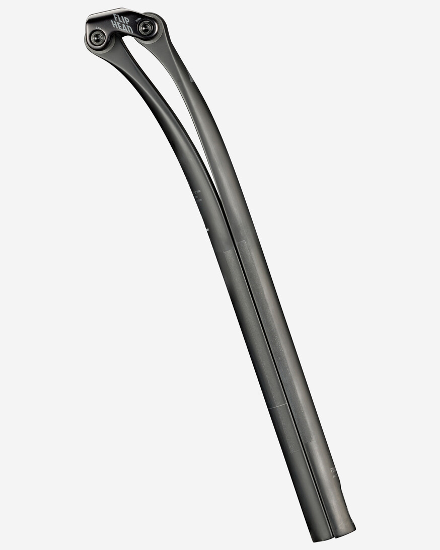

You don't need one, but I've got one of these ...
https://www.canyon.com/en-gb/gear/bike-parts/contact-points/posts-and-clamps/canyon-s15-vcls-2.0-cf-seatpost/148287.html
and it's the absolute mutts nuts.
Posted : 07/06/2022 8:13 pm
Posts: 1819
Those Canyon posts are very good. One came on my grail and although you don’t feel any movement while riding, my friends said you could see it working on the rough stuff. Only issue is grit and small stones get in the gap and start to rub. I covered the area with a strip of helitape but it still started to eat in. Resorted to cutting a wedge of Moto foam to fill the gap and it’s been perfect since. Flip head came be rotated as well to vary amount of set back.
Posted : 07/06/2022 9:14 pm
Posts: 6829
The screw holding the cradle on my Diverge seatpost snapped and Specialized don’t have any spares so they offered me a warranty replacement - the only one available in the right diameter and offset was the S-Works one. It is noticeably flexier that the regular carbon post it replaced. Always fancied the Ergon/Canyon one - Redshift or Thudbusters seem a bit of overkill.
