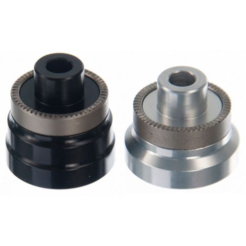

Advice would be much appreciated.
Posted : 23/09/2014 10:42 am
A set of 135mm end caps. Check the hope tech help page for the part number

They're £13 from any Hope dealer
Posted : 23/09/2014 10:47 am
Do they just drop into whats there, like the front hub end caps?
Posted : 23/09/2014 11:22 am
they go over the axle, have to take cassette off as well. pull off, press on.
Posted : 23/09/2014 12:29 pm
Posts: 4593
Yep, two minute job. Just went 135xQR to 12x142.
Remove old caps, replace with above QR adaptors. Very simple.
