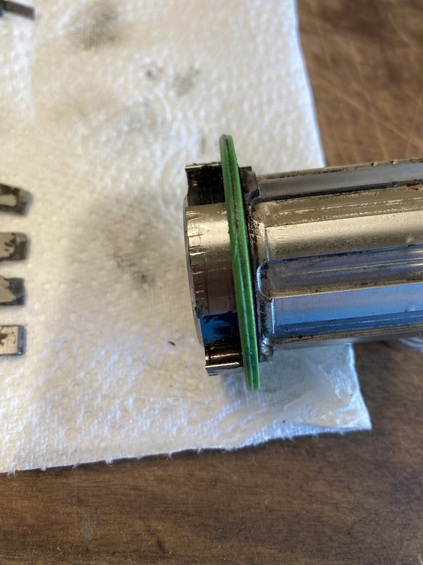

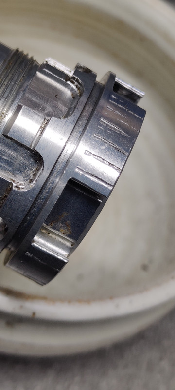

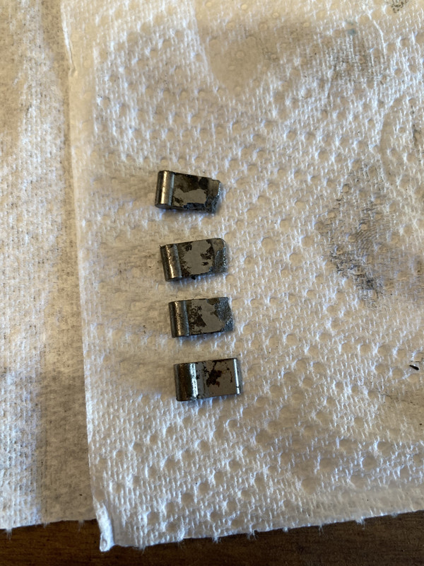

Posts: 3328
On this free hub, turns out the famous inner free hub bearing is absolutely fine.
No axle damage.
@Scienceofficer Here is the free hub body (steel) which looks very like yours, and the pawls. Three are buggered, one is OK. Hub teeth seem OK, but really it's quite hard to tell. Maybe they really not in great nick if they are gouging the free hub body like that?
I've fitted another free hub for now, again. (I have got very used to multiple levels of redundancy). And also gone back to the bolt through. @big_n_daft Interesting video, nipped up the bolts to 12nm, which is considerably more than I ever used ot put through them, and of course a lot more than the cheese based maxle.
It does seem to be heading towards an issue of axle flex, I have a feeling one last roll of the dice with a DT Swiss hub would be worth it. Certainly far less than a whole new bike.

Two comments
I used to get similar scoring on hope xc hubs, definitely flex in the axle
The scoring I had was over more of the freewheel, suggests it's not seated fully
