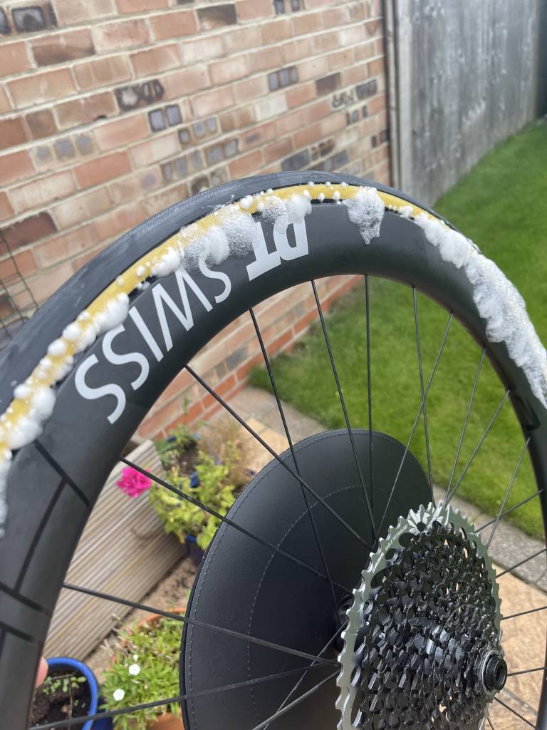

So, the Stradas have arrived and are fitted - just. They were a bit of a bugger to get on - not too bad though and I don't have much else to compare to since this is the first time I have fitted such narrow tyres onto anything so 🤷‍♂️. Impossible without tyre levers and some soapy water though. The 35mm Mondos I could get on and off by hand on the same wheels.  I was definitely reluctant to use tyre levers on my carbon wheels but I have the plastic Schwalbe ones and I was very, very careful. They tyres did go on though, a cm at a time for the last 10cm. Needed the compressor to seat them and I used Schwalbe EasyFit solution so the beads snapped in no problem. LOADS of air coming out of the sidewalls though and making bubble bath proportions of foam from the Fairy/EasyFit solutions. No sealant in yet, I thought I would leave them seated on the rim overnight and then decide if removing one of the beads to pour the SmartSeal in is a good idea or not. If not I will use Orange Endurance and inject it through the valve. Hopefully it is good enough to seal the sidewalls....
IMG_1482
Posted : 30/09/2023 12:15 pm
