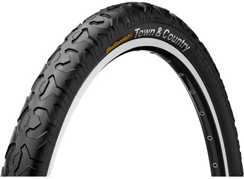

I've always thought the Conti Town & Country tyres look good, the reversed tread should be better on the road then side knobs, depends what the grip is like off road, but at least it should be softer when you crash 😆
Posted : 20/11/2017 3:20 pm
