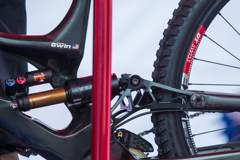

Firstly you need to dismiss the one off air shocks Fox are making for Gwin to race with, they're not production ready or available to you or I....likewise the one off coil Fox fitted to Graves bike for the last EWS race shouldn't really feature in the discussion, these are racing prototypes that may or may not make it to the shop floor.
I've been vocal in the past re. the advantages of coil forks, up until a few months ago I was running a TFtuned coil sprung Sektor that was bloody ace....smooth on small bumps, no bottoming out on tough stuff and stunningly reliable....I just couldn't see the appeal with air forks that leak, require inflating, regular servicing etc....
That said I did rate the performance of a Fox RP23 that came on a Saracen Ariel I owned a few years ago...the Float-32s it had were dire but that's a different story....the shock was very good.
So when a 'cheap' Revelation SoloAir came up recently on Wiggle I took the plunge, I didn't want to replace the Sektors but like a numpty I'd cable tied brake hoses to the crown steerer and caused some unsightly wear...new forks were needed and 26inch stock seemed to be going cheap.
The Revs have been great, easily as good as the coil spring Sektors out on the trail, I can't comment on longevity yet but I have taken them on XC type runs around the local woods and uplift days all over the place...just play with the pressures and away you go....it's got me thinking.
My next bike is going to be a DH bike and I'd thought I would do the usual coil shock and perhaps get flashy with some titanium springs in the fork but now I'm not sure...seeing how good these new Revs are and how good the RP23 from four years ago was I think I'll probably go frame only and build it with whatever DH air stuff is on the market at the time....realistically with a recent house move this is probably a year or two away, if I was building one now I'd probably still use a coil shock but air forks.
I wouldn't go as far as to say I'm a convert but I welcome the additional choice, air suspension is definitely bridging the gap to coil stuff for gravity type riding.
(You can keep tubeless tyres however!...far too much faff, I'm a serial tyre swapper so breaking beads, cleaning up sealant, playing with compressors etc isn't for me. Thanks to Snakeskin and Exo sidewalls I haven't pinch flatted in years and can happily run 25psi all day long).
Posted : 12/08/2015 11:40 am
deviant
Gwin's bike
[img] ?1433443013[/img]
and the Float X2 on [url= http://www.wheelies.co.uk/p79195/Fox-Racing-Shox-Float-X2-Air-Shox-Factory-Series-Rear-Shock---Kashima-Rear-Shock-2016.aspx?gclid=Cj0KEQjw3auuBRDj1LnQyLjy-4sBEiQAKPU_vYSmyvdF9NAvkah_7gHDWK3sS2AAxx-XXH-Oq-sR1BYaApwK8P8HAQ ]sale.[/url]
Granted, Gwin may have custom internals but twas ever thus in terms of what elite riders and racers have access to.
