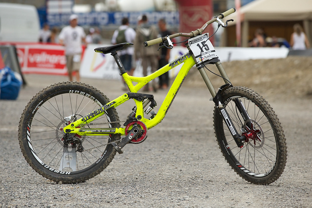

deviant
...for me there is still just a slight gap in favour of coils for truly horrible riding (and i'd class an Alps bike as needing to handle horrible stuff), if i was building a 120mm allrounder i'd go with air every time but for a big bike i'd match a coil shock to the coil forks you already have.
[img] ?1375052989[/img]
Just sayin.....
