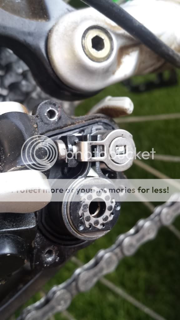

Yeah leave on all the time..... Its not really a spring.... Its just a cam that tensions a bit of bent metal around a central pin which the swing arm of cage is fixed to.... The cam acts on the bent bit of metal to tighten.... Like a strap.
Here is a pic of mine.... I found that the tension was a little weak on mine out the box so I needed to tighten the preload screw.
