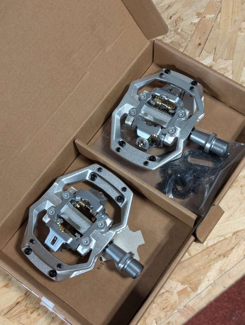

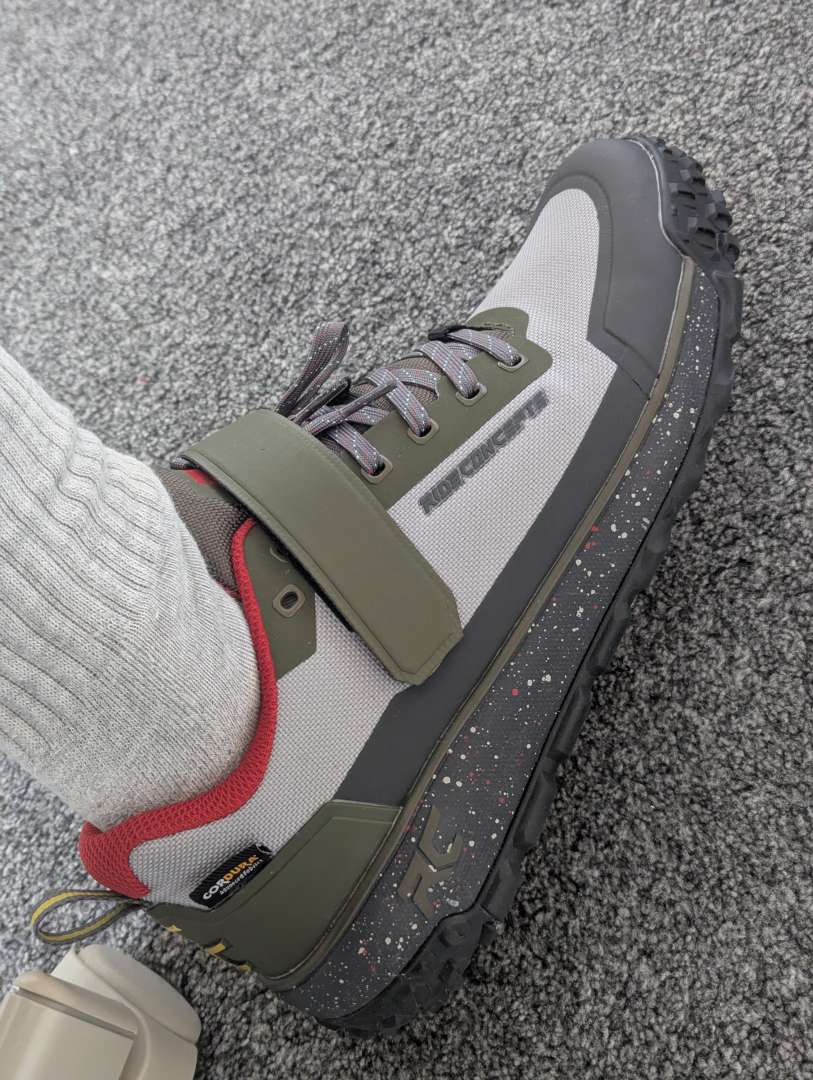

After 20+ years of actual mountain biking I am about to grow up and learn something that I should have done a long time ago.
Motivated by curiosity (but mostly by 50% discounts on shoes and pedals) than any perceived boost in performance or riding ability, I am going to learn to clip in.
Now, I've definitely clipped in before, but only for one ride every 5 years or so. I always found it terrifying trying to attack technical trails with my feet attached to the bike. But, it's clearly the correct, mature way to ride a bike properly so I need to stick with it and figure it out.
I have never invested in decent pedals, they were usually borrowed, and I have never tried modern shoes. Shoes where the cleats go all the way back to where I would actually like to have my foot positioned on the pedals. I hated being perched on my toes with my heels swinging from my tortured hamstrings.
I've quickly tried these in the garage and my foot sits in a really nice spot. They also accommodate a bit of my duck-foot stance. It feels promising. I chose shoes that get good reviews for hiking around off the bike, so when I go over the bars and slide down a hill, I can climb back to the trail.
I can't ride until tomorrow morning. I'm also home alone with no car so it'll be a mellow local test ride.
How long before I go crawling back to flats?

Those nukeproof pedals come extremely tight from factory
Fully tighten the mechanism and leave it over night and then loosen off (i have 2 pairs)
I also point the cleat towards my big?little? i cant remember? toe so that i have just enough rotation of my foot before unclipping easily, and so that i can't rotate my heel into the bike

Spend a few mins clipping in and out in a park/field (so you’ve a softish landing for the inevitable) then by the time you’re back from your first ride it will be second nature. I still twist my feet when coming off flat pedals, despite not having used clips for years (foot issue, would love to go back.) best bit about them is having you foot in the right place, all the time.

Echo what the above poster says about NP clipless. Even with them fully backed off they're crazy tight. I have them wound all the way out and they took quite a few rides to loosen up to something that didn't feel suicidal.
I'm using them with Hellcats, which allow the cleats to be slammed all the way back (lifelong fiat rider here) and also have wildfowl stance, and they work ok for me.
I still can't ride as aggressively as I can with flats, I think I may need to modify the shoes to get them even further back, they just don't feel 'right', and I'm about a year in.

I bought some NP clipless in the CRC fire sale and find them terrifyingly tight so have gone back to Shimano M520s. I'll try the trick of winding them all the way in for a couple of days though. I think I'd like the platform as a bit of extra space/protection, plus they are a fun colour...

also remove the pins so you just have the cleat and the platform for support.
push the cleat really far back so it feels similar to flats, i do this with the hope gravity

A mate uses Nukeproof clips and says their own brand cleats work far better than Shimano cleats (which do work but apparently are harder to unclip from). Personally I find techy climbs are the only time I ever fall over due to being unable to unclip, very rarely but I've been using clips on all bikes for as long as I can remember (Crank Brothers Mallet DH with Mallet shoes)

I survived my first excursion.
I just pedalled over to Parkwood and back because it's fairly close to home. There's nothing tech over there but they do have loose gravelly berms and switchbacks and some small jumps. Perfect for messing around on.
No problems at all clipping out but clipping in is hit and miss, literally. I was jabbing at the pedals quite a bit before finding the right place and then the engagement wasn't always obvious.
Normal riding around, no problems whatsoever. I managed to hit some of the smaller doubles and pop some mannies in the rollers. I was a bit scared of washing out and not being able to dab but it didn't happen. It's very dry and dusty today.
I recognise the 'standing on an ice cube' description from when I've tried clips before but it's mostly absent here. I assume the shoe is flexing to meet the platform but I need a second pair of eyeballs to confirm it. Anyway, it feels like a normal pedal most of the time which is perfect.
I did experience a bit of 'float'. On berms and jumps where I'm using a bit of body language, if one of my feet goes light I can feel it swivel a bit. Is this normal or should they be set tighter?
Also, these pedals were £48. So, I'd like to try Crank Brothers or Hope but they at least double the price. I'll try them later if I stick with it.
The shoes were £80 and I'm very happy with them. They put my feet almost where I would put them on a flat pedal and they're comfy and grippy for walking around in. If there's a shoe where the cleats go even further back I'd be keen to try them.
So for the first time ever, I'm leaving the clips in place for a second attempt. The real test will be Wharny or Win Hill when it starts getting steep and rough.
