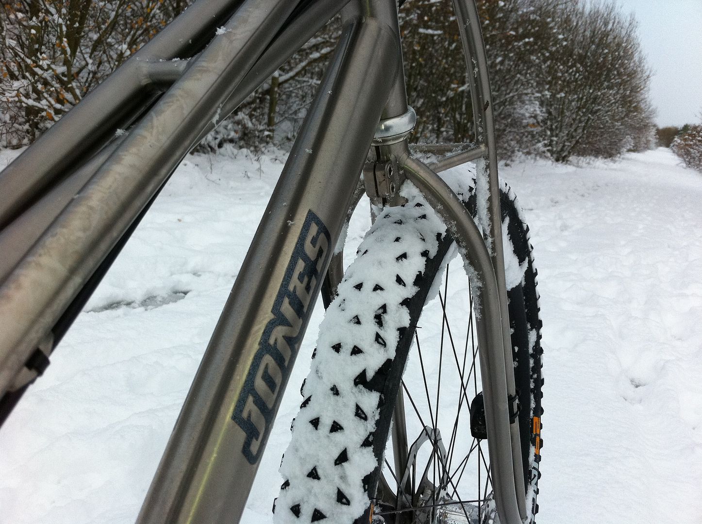

Have you tried skinny at the front and fat (spiked) at the back?
[img] http://images.fotopic.net/?iid=1fq4nk&outx=800&quality=70 [/img]
[img] http://images.fotopic.net/?iid=1fq4nn&outx=800&quality=70 [/img]
