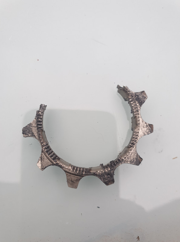

Posts: 902
The 11t cog of my ZTTO cassette somewhat disintegrated. Quite disappointing for an 80 quid thing.
I've just replaced it with a deore cassette as I found another cog with teeth missing.
Here's the 11t cog:
cog
Posted : 05/09/2022 9:40 pm
