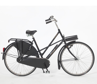

gingerss - Member
...Here's hoping manufacturers will wake up and realise that not all singlespeeders have a beard and want a steep bike with 100mm forks.
here you are...
Posted : 14/02/2012 12:22 pm
here you are
After seeing that skillful French bloke on something similar I think it might just be the latest 'must have' format. I wonder if I can get one with the top tube re-enforcement already added?
Posted : 14/02/2012 12:26 pm
