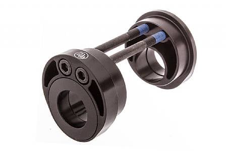

Anything with pf30 and then use

I've done the same with a chinese cx frame.. I used beer components ebb and I must admit I was sceptical about slippage etc.. I needn't have worried it works brill and looks clean 8)

Good idea, I hadn't thought of an adapter, but at [url= http://www.charliethebikemonger.com/problem-solvers-eccentric-46-bottom-bracket-pf30-adapter-4163-p.asp ]an extra £126[/url], it makes a cheap Chinese frame not so cheap.
I'd rather buy a purpose built frame if I can.

only thing that puts me off is I was adjusting rear wheel once a week minimum for chain wear on my sscx commuter in cruddy weather - that's a lot of bb faffage.

I've got a barely used Problem Solvers ebb for £50 if you want Graham.

I have the Fr216 Chinese carbon frame, I think it was about £210 posted from eBay, there are loads on there! I accidentally ordered a PF30 but found a press in Fsa adapter for a PF30 BB, the frame has been really good, very pleased for the price! There is a guy in a club I have been out with before who has the same frame with an eccentric BB setup and he said its been really good. Mine might go So nearer the end of the year.

Not as much faff as it looks to adjust chain.. Slacken two bolts/tweak bb cups with lockring tool and tighten bolts 🙂
