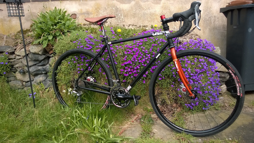

Go easy on me, there are a few bits that are not finished, stack height and red spacer for e.g.
Here she is
Got to say I'm seriously happy with it. It is weighty compared to a standard road bike but it really doesn't ride like it. It's smooth and has a really quick turn of pace.
I had it in the fields and tracks yesterday and will be commuting tomorrow for the 1st time.
Love it
Posted : 14/04/2016 7:34 pm
That's a nice build. What crankset are you using?
Still scratching my chin on what tyres to use lol. CX or road?
Hope to complete my build this weekend.
I managed to find the original Tange fork for £77.
I might run into chainline problems using am 10 speed GXP crank for a road bike 130mm OLD.
Did sone calculations and may 1.5 mm out...
Posted : 14/04/2016 9:54 pm

That looks nice!
I have a pair of the PX forks bought on a whim over a year ago and never used, might have to go find a plug for commuting duties now...
Posted : 15/04/2016 5:58 am
Looks ace. Much like mine will I hope
Posted : 15/04/2016 6:03 am
Cheers all
Can't remember the exact model of the crankset but it's Tiagra equivalent I think, looks really nice with the frame.
I have Clement USH on Pacenti CL25 rims and they seem to roll very nicely on the road so a good compromise between road and cx Frankenstein.
I would say everyone who picked a frame up at £130 has a really nice frame for a bargain price.
Posted : 15/04/2016 8:19 am

Transferred my older 10spd Rival gear.
Used a CX70 top pull FD and Spesh Phat bar gel tape.
TPR Hy/Rd. Hope Headset.
11-28 and 50/34T compact.
Carbon post and Ritchey bars and stem.
Was a pain to set the pads rub free.
My old man likes it and I finished it on his birthday phew.
Cheers to Terry Wright Cycles for the bar tape and Bristows Cycles for getting me the fork.
Big shout to the folks on the forum who helped with a ton of advice including Mr Barrow 😉
Need some more Allen bolts to Plug (ahem) up remaining bottle hole threads.
Needs better pics but that's another day when I have time.
Posted : 13/05/2016 3:14 pm
