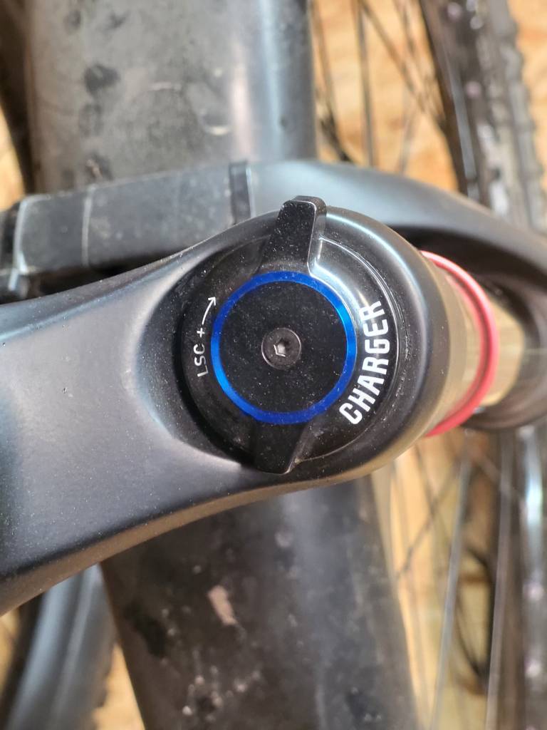

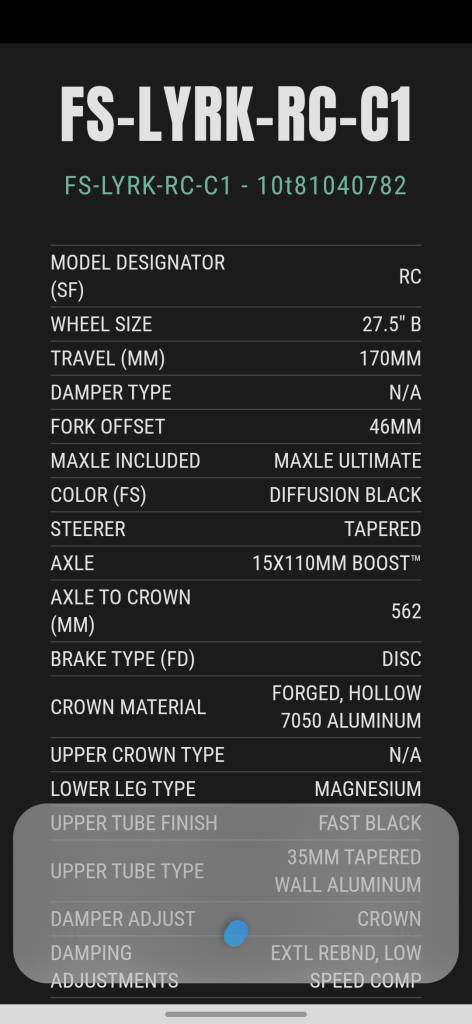

The top cap says "charger"
Trailheads says "n/a"
Without taking apart, am I missing anything in identifying the damper??
Top cap
Trailheads

Posts: 2923
So it has a c1 airspring but a poor damper from looking at the info on trailheads?
Posted : 13/06/2023 10:58 am

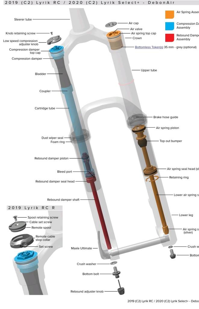

Posts: 9783
This shows the differences
Posted : 13/06/2023 11:14 am
Posts: 10225
Try page 27 of the following guide - might be one of these. Looks like it is a cartridge but with an ifp setup rather than the bladder full charger damper. Perhaps it’s similar to the basic Fox grip damper. Should be better than moco.

Posts: 347
My guess would be it has a charger bladder style damper but with only low speed adjust and the oldest debonair air spring.
If so I had the same fork  changed the air spring for the C2 (I think? Not the newest but the one before) as that really improves the spring side but it was a decent fork
You could just take the tops off and check.
Posted : 13/06/2023 12:23 pm

Posts: 1352
Thats a Charger2 RC bladder damper, not the IFP based one.
Posted : 13/06/2023 12:52 pm

Posts: 2923
Fork whipped apart and as @rickdraper said
Charger damper with rebound and lsc
And 170mm air spring
Both now going spare of anyone wants them!
