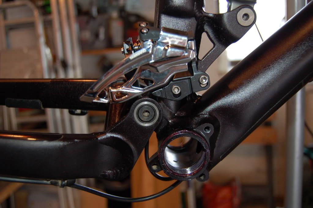

No, you'd limit it to not shift past the middle ring. It may work. Here's what the double looks like,on a Nerve AM frame:
See how the mech cage exactly fits the diameter of the larger ring.

Cheers for that and the pics, I had a 2012 XT double set up on my hardtail but that was a conventional front mech and double specific 40,28t chainset.
Really don't want to have to buy a new chainset and as you've said it would look horrendous just removing the big ring.
I think it will work but might have to end up either getting a double front mech or adjusting the limit screws to stop it fouling on the bash.
