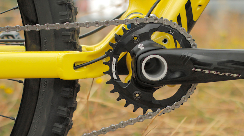

You'll have trouble finding a 3-arm n/w ring.
They're meant to be launching a 386 single ring (called Megatooth) which isn't narrow wide but is meant to offer similar retention properties (image links to PB article), and should be available any time now.
