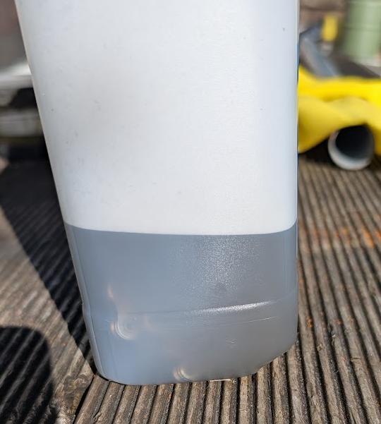

10:1 Surfex HD, that went much dark much quicker than I expected and a lot darker than I expected given the chain looked quite clean from the outside!

3 runs of surfex hd cleaned the chain (+1 for luck and 2 IPA rinses). Reused the fluid on the oily car engine 😜. Chain now nicely waxed.
