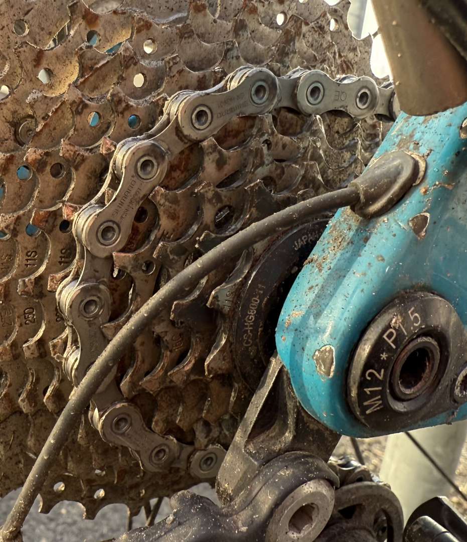

Posts: 10539
Nope, it’s the whole cassette.  Silca Hot Wax with the endurance chip.  This is it at 180km.  It certainly doesn’t feel like it’ll do 600km.

Posts: 21461
Ah, looking at that, I'm thinking road salt. Did you get much snow your way? If there's still that much salt about, I'd probably give the whole bike a warm water rinse when I got home.

Posts: 3529
Ah, looking at that, I’m thinking road salt. Did you get much snow your way? If there’s still that much salt about, I’d probably give the whole bike a warm water rinse when I got home.
I’d agree. It’s a constant battle to clean the salty grey crap off the critical bits of the work van at the moment.
It’s one of those times where I have to stop mid journey to clean the headlights and door mirrors. I imagine a commuter bike won’t get anywhere near its normal distance without extra lube and attention.

Posts: 172
It’s a weak point of wax. I prefer to run plated chains, but really on salty roads a rinse and dry with a towel works best. Love wax for the nice bikes, but for commuting I find a belt hard to beat.

Posts: 10539
I’ve (tooth)brushed a little ceramic lube onto the cassette sprockets to keep me going.  My drip wax won’t arrive until after the 22nd.  I may relax the chain this weekend or simply swap to my other pre-waxed chain.  Let’s see how it goes.
@onzadog - yes, it’s been very cold here over the past few weeks.  Only a little snow, but always -5 and below so lots of grit sprayed everywhere and little to no rain or mel****er to was it away.  Yesterday was very misty around Bristol which led to a lot of surface water and suspended moisture.  The bike is utterly filthy after just 60km on road.  IMG_8386IMG_8384IMG_8385

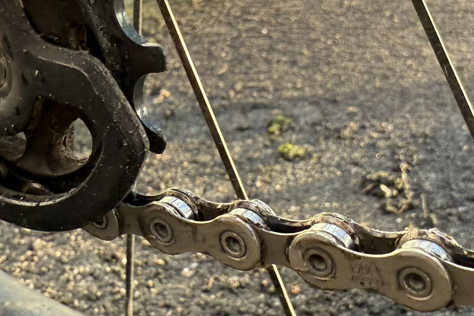

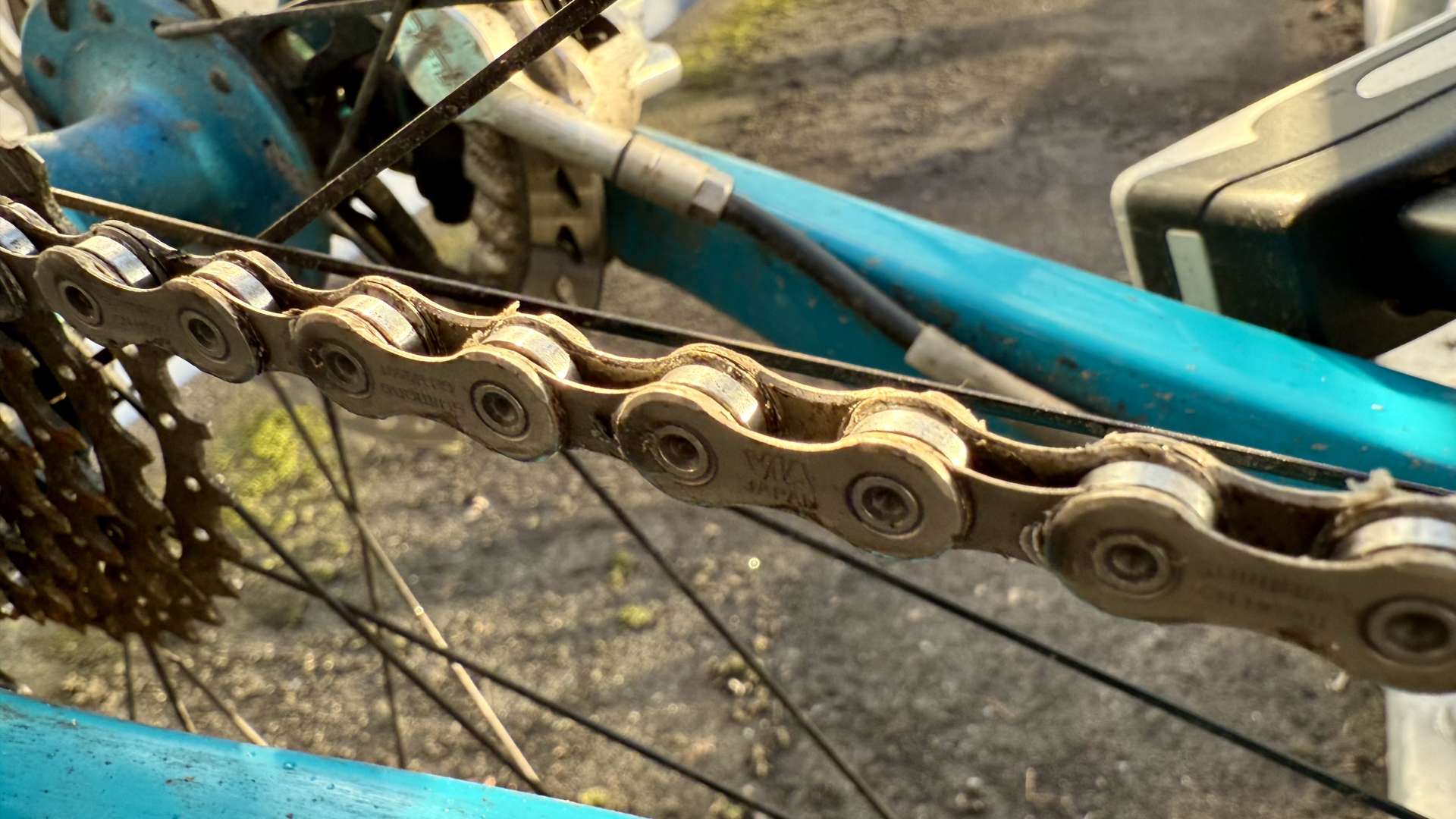

This is the commuter chain after maybe 250km of mostly dry, but cold and damp miles.  It did lightly rain on one 60km commute.
Posted : 12/03/2025 9:18 am
