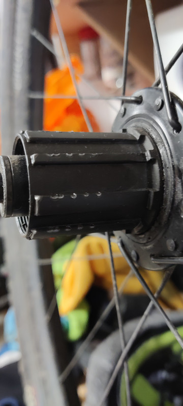

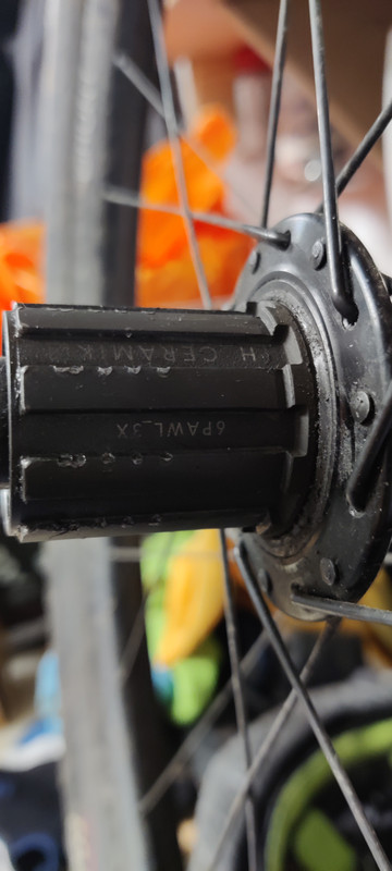

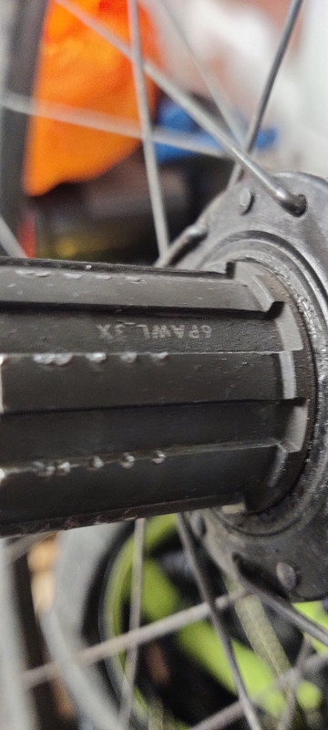

Photo of your freehub would be useful.
If the freehub is notched through wear then a small sprocket might not be sliding along the grooves properly and then the lockring, although tight against this smaller sprocket, isn't compressing all of the cassette
If you do need a spacer, put it between the hub and the largest sprocket. HT2 BB spacers work.

Photos below, I hope 🤔 there is some chewing of the freehub. These wheels have only done about 550 miles and none of it 'technical'.
hub
hub
hub
Section of cassette that was moving is made up of 5 largest cogs which is a single carrier. The rest are all loose cogs and spacers.

Yeah, it's possible that one of the smaller sprockets is getting hung up in a notch and not closing the gap to the next one. I'd take a file to the FH to get rid of the raised bits around the notches then re-try.
Posted : 25/10/2022 6:02 pm
