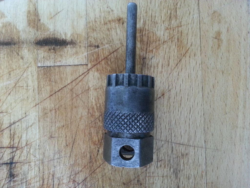

For my tour I drilled a hole in a standard cassette removal tool that my allen key fitted into.
You have to use your chain and pedals to hold the cassette in place, its not pretty but it works (unless you carry a chain whip?)
