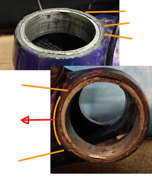

So finally with brute force and effort i got the sleeve and cup apart... there's a couple of tiny tiny marks on the sleeve, but with a bit of sandpaper and a gentle tiny file I got them smooth enough.
I then did a test fit, but it was slightly out of round... However, not a lot and was easy to get back again into the right shape. we're talking 0.1mm on the digital calipers.
Looking at the sleeve it's not bonded, there's no sign of any glue of any description on it. The surface on the frame is completely smooth and no discolouration to imply it's got any glue on it either. The sleeve slots in with a press, but it's a tight tight fit.. .tight enough to convince me that it's not going anywhere..
It fits flush and nice all the way around.
Whilst i can't say i'm 100% happy... i'm a lot happier than i was with it a few hours ago that's for sure.

Looks like multiple stress/cracks around the head tube which is likely why the sleeve was debonded and no longer interference fit.
Is this the frame '08 got ejected out the front on?
I'd say it's borked.
Posted : 24/01/2023 8:49 pm

Ok, heres what I see in the pictures: (real life may be different and light may be playing tricks)
3+ stress cracks to the rear of the lower head tube.
2 major delamination's/multi layer cracks to the 5 and 8 oclock positions on the head tube that show with the reinserted sleeve an opening up of both cracks and space between the sleeve and frame.
The stress cracks in the top image indicative of the resulting deformation of the frame at this point with that rearmost part of the headtube having been deformed towards the rear of the bike.
If the sleeve is now out of round, this would tend to suggest that the crash impact essentially ovalized the insert, stressing the carbon and causing the frame failure.
I would guess that carbon repair would require significant material removal and a multi layer circumferential wrap around the head tube running into the downtube.
I would say that this is not cost effective to repair for the next time '08 blows up the front end as I'd think you'd be looking at complete explosive flames failure with just a re-epoxied insert.
I am not a carbon repair expert.
I have repaired several carbon bikes that both I and my kids still ride.
I would not let my kid ride this one with a sleeve only repair.
other opinions are available and mine is only worth what you've paid for it 😉

All perfectly fair comments... Once the sun is up and a bit of daylight, i'll get checking closer. When the sleeve was out i did give it a good look over on the torch/lights, but obviously i can only see what i can see... I'll also get a responsible grown up to have a look as well 😀
The sleeve was only out of round due to me compressing it in a vice to get the cup out. I don't think it was out of round when it came out. It was round when it went back in.
If the frame is dead, then that's how it is, it's far from ideal of course, but we'll deal with that and better knowing now than in 6 months mid-season. As to what the plan would be... heck, i dunno. But happily, he's got a spare bike lol.

Should the flat spots in the insert not line up with a flat spot on the inside of the head tube?
Seems odd that you've re inserted it at a random rotation?
I'd have thought the flats would go at 12oclock or 3.15.
Personally from looking at the face of the head tube I'd not ride that.
Looks like it's been sanded down on a pavement by Sam Pilgrim.

It's hard to see as the flats on the frame don't go right to the end, but yes, they're aligned accordingly.
Looks like it’s been sanded down on a pavement by Sam Pilgrim.
THat's only the paint that's not present on the bottom.. I don't see it as anything more than that.

edit. Just spent the last 5 minutes in the garage.. (BRRRRR) i'm 100% happy there's nothing untoward on the frame in terms of cracks, splits, deformations. The marks you can see are paint/lacquer only issues, I've not looked on frame2, but i expect they just loosely paint that bit or the paint sticks to the cups, as the cups are pressed in afterwards. But to the naked eye, it's 100%. The carbon layup there is about 4mm thick, proper sturdy stuff...
I'd happily ride it... and of course will do so at times lol. 😀

The headtube does look knackered in those images in bearbacks post, but you're the one with access to the actual bike rather than some photos on the internet - photos can be misleading

So me and a mate have been looking... Happily we have a 2nd frame to pick any thoughts out of too, plus i needed to remove the headset cups on that one too.
What i've established is.... on the GOOD frame, there's paint beneath the spacer and potentially a bit of carbon too... on the purple frame that paint is missing. However, looking now, this is NOT new... this is old and has been removed from before when we've owned the bike. What it looks like has happened is that a previous owner has done this and removed the cups before, but when he's done it he's actually knocked out the non-removable (usually) spacer as well. You can see the chips/marks in the paint have been touched up (which you couldn't really see when everything was fitted without VERY close inspection).
So, removing the cup last night wasn't the cause of any issues, it's no worse than it was.... but admittedly it's no better. Whilst the paint is no longer present, there's nothing that indicates any extra additional damage to any of the carbon and it's truly massively over-engineered around that area.
Where does that leave us.. Well in truth, no better worse than we were before yesterday. Just with more knowledge that something has previously happened now. But i don't think the frame is any more 'broken' than he's been riding for the last 12 months lol.
Hamfisted animal!

However that does start bringing in massive levels of complexity
Obviously it's up to you, but in terms of the claim it is literally ~2 minutes work on your part and it's going to be a lot easier to find a solution with an extra few quid in the bank than not.

I wouldn’t claim for accident damage, but if he’s going to keep riding it, I would make sure he’s got good dental cover.
