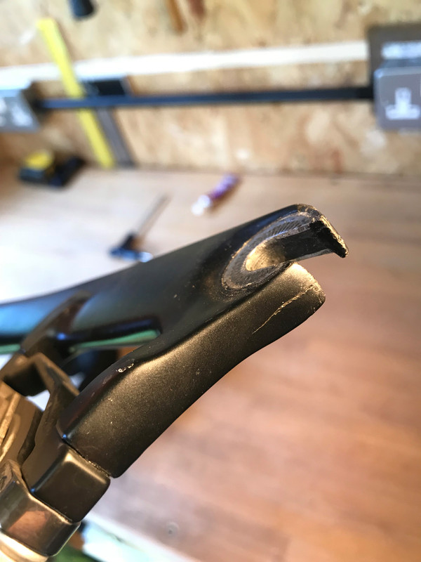

Fork image????So I’ve found a crack underneath the disc mount on my carbon road forks. Definitely a shallow crack as you can prise it apart. I’ll admit the drop-out looks a bit scuffed but I promise it’s only from placing the forks directly on the ground, not from whacking it with a hammer or crashing etc.
Forks are supposed to be in warranty but they’re disputing it based on a photo because (I paraphrase) apparently it’s unlikely to be a manufacturing fault in that location.
Any ideas? Keep riding then hit them with some bad PR when I lose me teeth?
<imgsrc="https://m.imgur.com/gallery/PzyVejw" alt="" />

The shop who have the distribution deal. Sorry - struggling with this sites image function...

Can't see photo but it's not just down to manufacturing - composites can fail prematurely due to poor design resulting in stress concentrations and accelerated fatigue failure. Most bike shops know diddly-squat about composites.

Sorry for perhaps the stupid question, but is that bit of the fork actually carbon? The dropout looks like an aluminium insert from your image.
I think you can get both types; full carbon, or carbon legs with alloy inserts.
It would be worth checking what type you have.

Hi Stumpy - there’s definitely an aluminium insert in there, and what I’m now wondering is how far that goes up the leg. I had assumed it was moulded carbon all around the insert, but perhaps it’s only paint over the metal which has cracked.

Hi Stumpy – there’s definitely an aluminium insert in there, and what I’m now wondering is how far that goes up the leg.
The post mounts for the caliper look like alloy to me; I reckon the whole lower section is an insert (as in, everything below the upper post mount is alloy).
Presumably if you unscrew the caliper you can see if the thread on the post mounts is alloy?
I'd also be tempted to gently tap the fork leg with an allen key (6mm or so) and listen for a change in tone that would indicate an alloy/carbon join?

Update:
I forwarded my correspondence with Cycle Republic to Boardman Bikes and asked if they could assist. Their immediate response was to ask for my address and post me some new forks.
Lessons learnt - Cycle Republic are pretty unhelpful, but kudos to Boardman’s customer service who are excellent!
