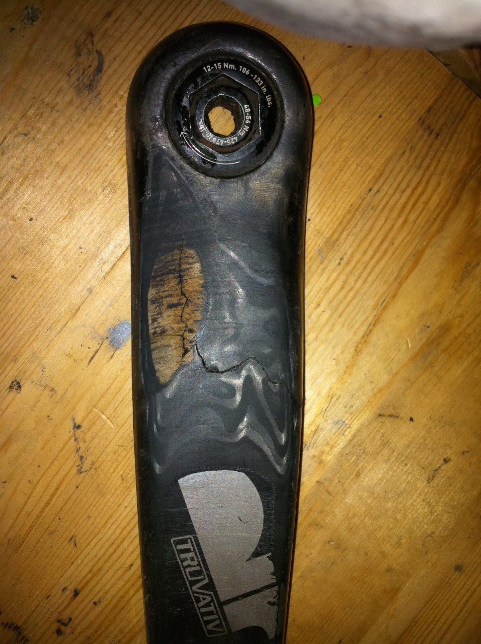

I took this picture a couple of weeks ago. Bike is only a couple of months old and the pedal hit a stump on the mellow part of a local DH run.
Saying that, the X0's on my Stumpjumper are fine even with some wicked rock gouges in them.
