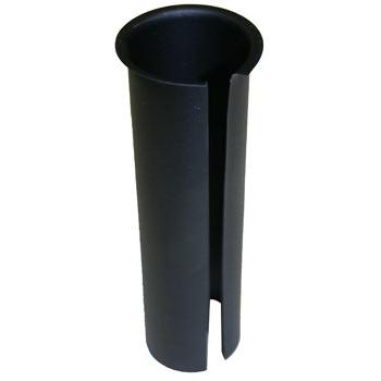

If the seatpost is smaller than 31.6. then you can use a shim. or buy a new 31.6 seatpost
(never used one of these so dont know how well they work)

Oh, and the seatpost - use some carbon assembly paste. Ideally don't use a shim as seen reports of many who end up with them stuck in. If you use an alloy post definitely use the paste, same goes for the bars. Carbon + Alloy can in certain wet/salty conditions result in the two bonding together, the paste adds a protective layer and regardless the paste reduces the amount of pressure and torque required to clamp things on, whatever the material. Certainly helps reduce seatpost slippage which I found happens a lot with the carbon frame.
