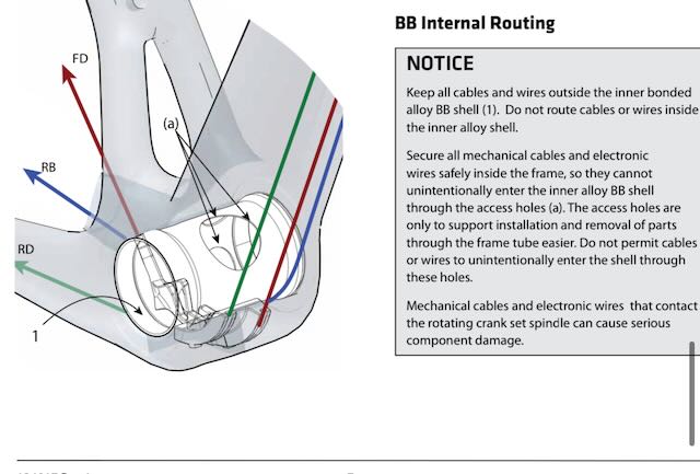

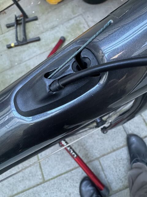

Theres a port in the downtube.  The manual tells you how to install it but not how to remove it....

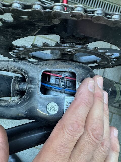

Theres a port under the BB.  Gear cable runs inside the red tube at this point.

You don't need the liners so don't worry about them. The port in the downtube comes out very easily now that the bolt is out, you just squeeze the small upper section towards the lower and lift.
It's a good time to replace both cables, but assuming you're only doing the rear mech you don't need to remove either the downtube port or the bb guide. Just send the cable through the downtube port and down to the bb guide, using the front mech cable tension to hold the latter in place. Use your fingers to find the new cable at the bottom of the downtube and feed it into the bb guide.

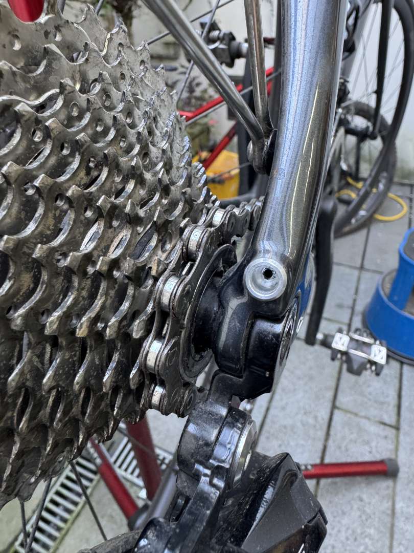

thanks. Downtube port had been pushed  too far at factory. But have levered it out. That revealed end of red inner. Tried cotton but it snapped. Fed new cable in but can’t get past the exit port on the chain stay.
can’t see any way of lining up inner and hole with a cable in either direction
drilling out chainstay and down tube port to run continuous outer sounds like the winning strategy IMG_5856.jpeg

The port in the frame at the rear mech is just an alloy insert - no need to drill, it should just pull out unless corroded in.

A little late. That became evident when it span as I drilled it, but it was pretty solidly in there - the drill had done most of the work before it span.  Anyway, now has full length outer so solved.
